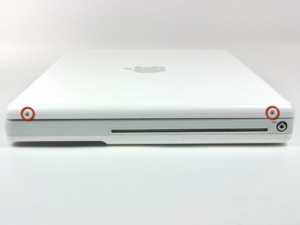

Add Note Edit Step 3 — Rear Display Bezel  ¶

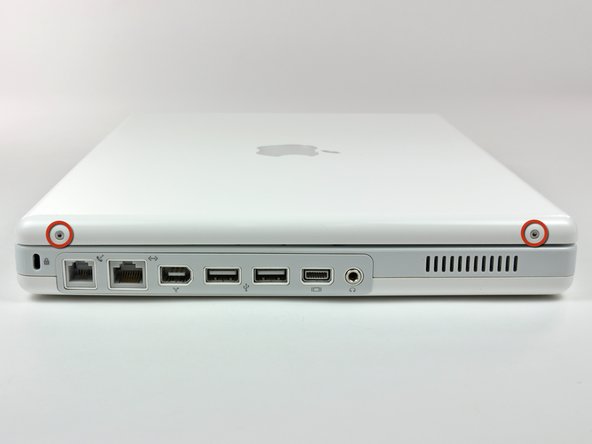

  • Use a 1.5 mm hex screwdriver to remove the two hex screws on either side of the display (four screws total).
  • If you don't have a 1.5 mm hex driver, you can probably get these screws out with a T6 Torx screwdriver. However, if you use a T6 Torx driver you'll be more likely to strip the screws.

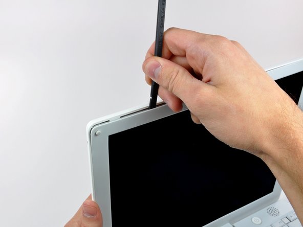

Add Note Edit Step 4  ¶

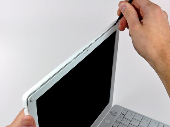

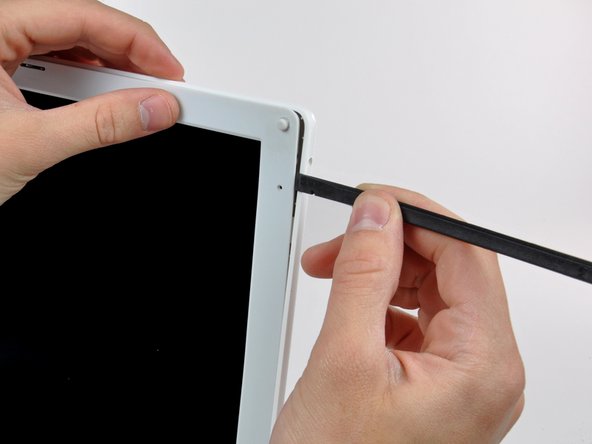

  • Insert the flat end of a spudger perpendicular to the face of the display into the gap between the front and rear bezels near the upper left corner of the display.
  • Rotate the spudger away from the display to pry the rear bezel off the front bezel.

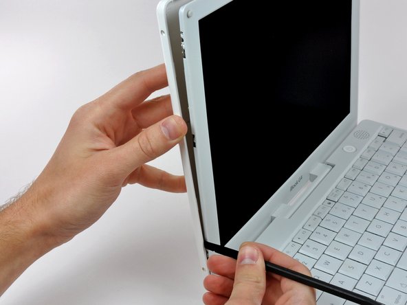

Add Note Edit Step 5  ¶

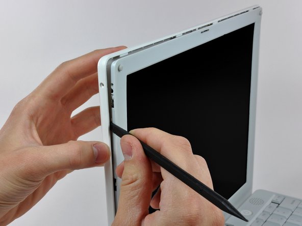

  • Run your spudger along the top edge of the front display bezel to evenly separate the two bezels.
Image #1 Image #2
Add Note Edit Step 6  ¶
  • Working down from the upper left corner, use the flat end of a spudger to pry the rear bezel away from the left edge of the display.
Image #1
Add Note Edit Step 7  ¶

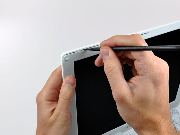

  • Use the flat end of a spudger to pry the rear bezel away from the right edge of the display.
  • If necessary, pry along the bottom edge of the rear bezel to separate it from the display assembly.

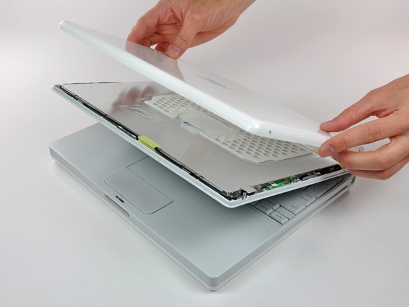

Add Note Edit Step 8  ¶

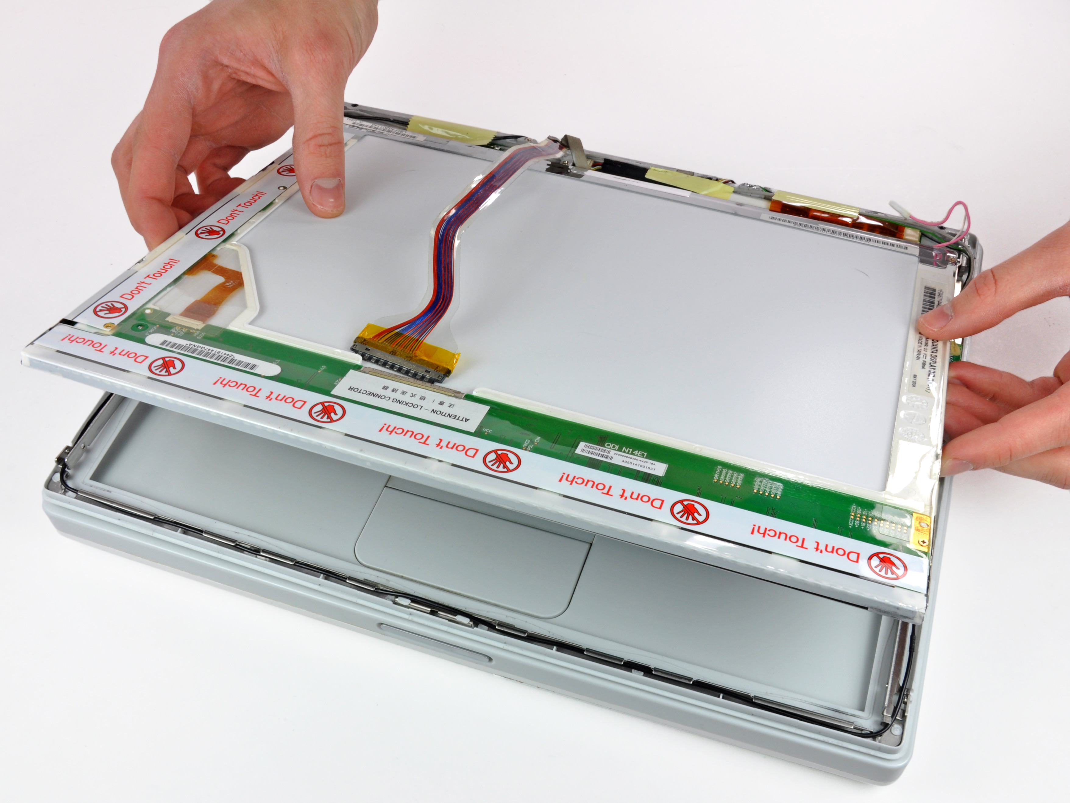

  • Lift the rear bezel off the display assembly.
