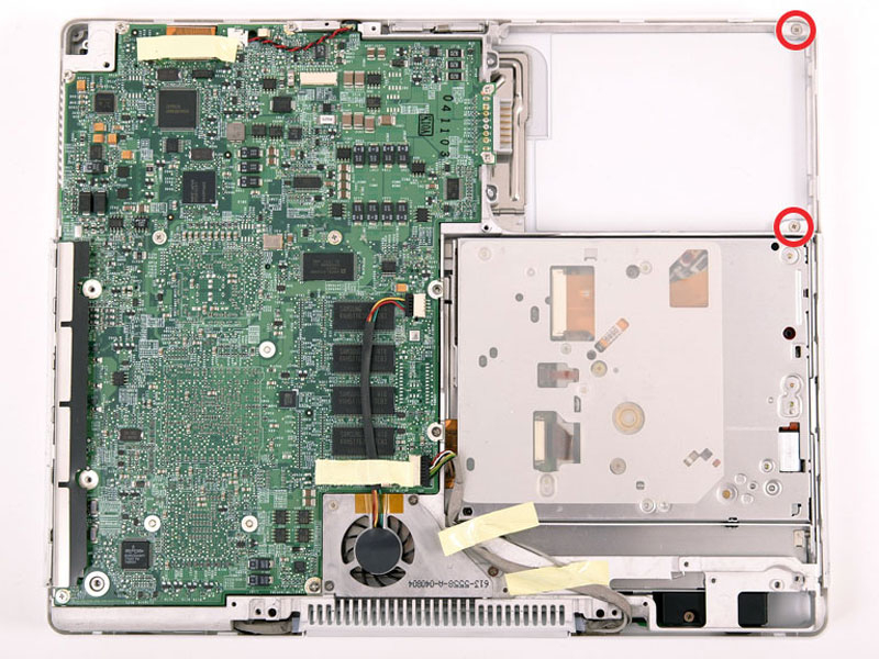

Add Note Edit Step 7  ¶
  • Remove the two Phillips screws on either side of the battery contacts.
Image #1
Add Note Edit Step 8  ¶
  • Breathe deeply. Trying times are ahead, but we promise the lower case does come off.
  • Push the thin rims of the lower case surrounding the battery compartment in, bending them past the tabs, and then lift up to free that corner of the lower case.
