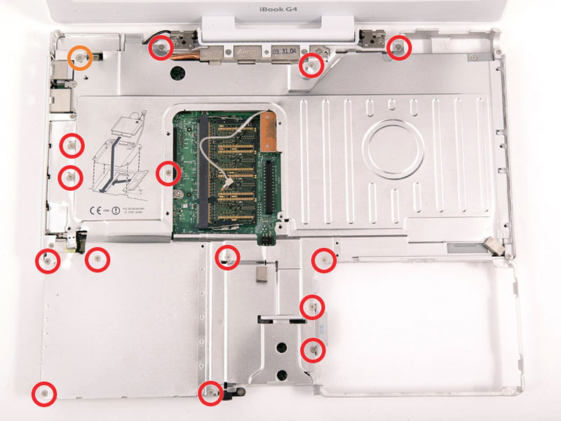

The metallic top shield protects the logic board from electromagnetic interference.

  • Use a coin to rotate the battery locking screw 90 degrees clockwise.
first image
Add Note Edit Step 2  ¶
first image
Add Note Edit Step 3 — Keyboard  ¶
  • Pull the keyboard release tabs toward you and lift up on the keyboard until it pops free.
  • If the keyboard does not come free, use a small flathead screwdriver to turn the keyboard locking screw 180 degrees in either direction and try again.
  • Flip the keyboard over, away from the screen, and rest it face-down on the trackpad area.
