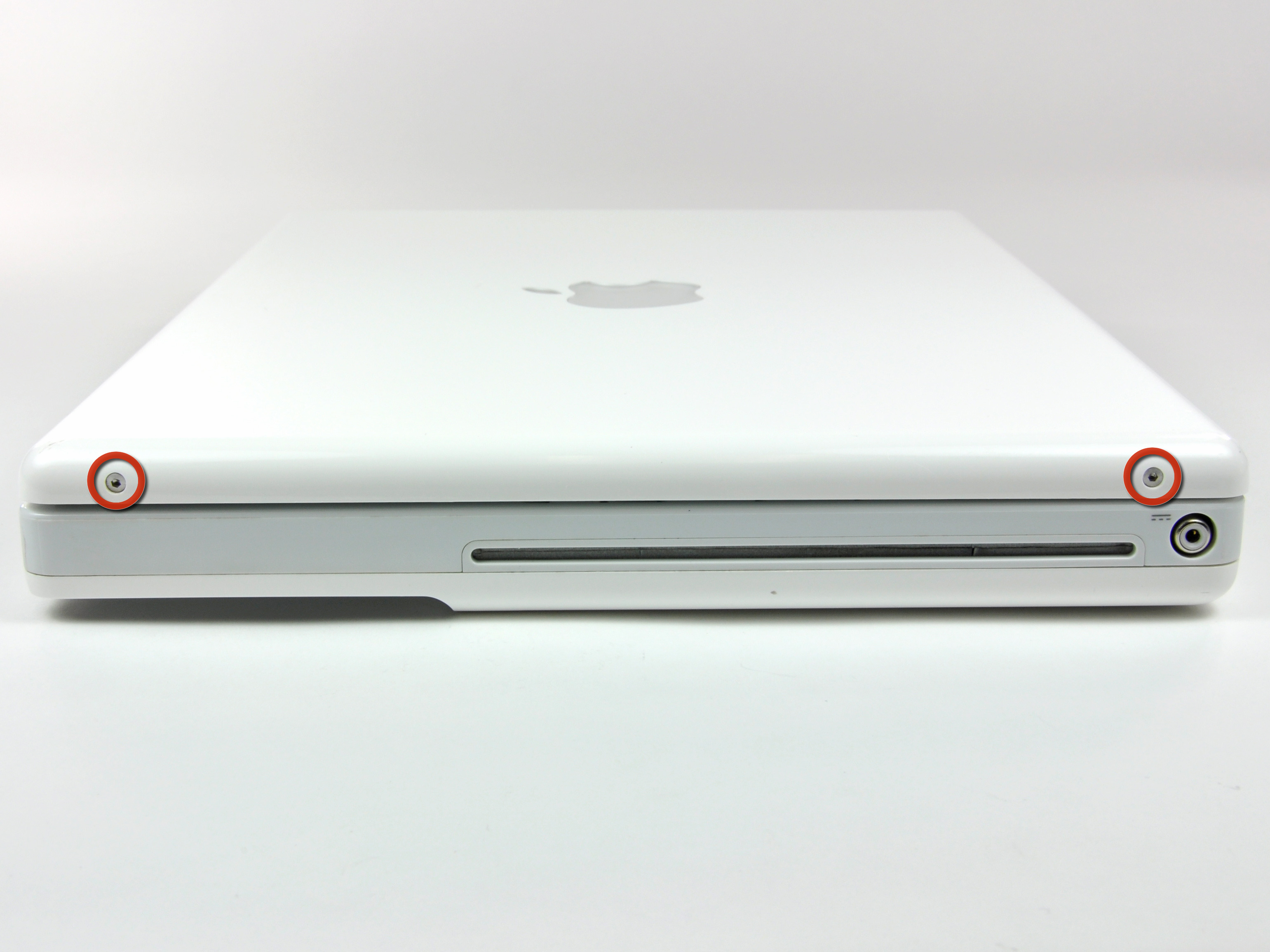

Add Note Edit Step 3 — Rear Display Bezel  ¶
  • Use a 1.5mm hex screwdriver to remove the two hex screws on either side of the display (four screws total).
  • If you don't have a 1.5mm hex driver, you can probably get these screws out with a T6 Torx screwdriver. However, if you use a T6 Torx driver you'll be more likely to strip the screws.
