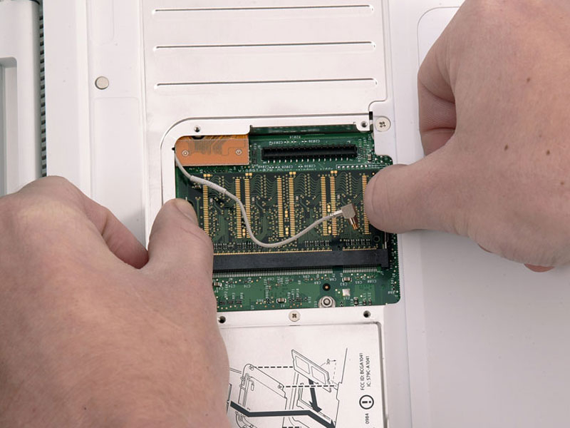

Add Note Edit Step 9  ¶
  • Pull the keyboard cable up from the logic board, holding the cable as close to the connector as possible.
  • Make sure that you reconnect the keyboard cable before replacing the RAM shield.
Image #1
Add Note Edit Step 10 — RAM  ¶
  • Release the tabs on each side of the RAM chip at the same time. These tabs lock the chip in place and releasing them will cause the chip to "pop" up.
Image #1
Add Note Edit Step 11  ¶
  • Pull the chip directly out from its connectors.
