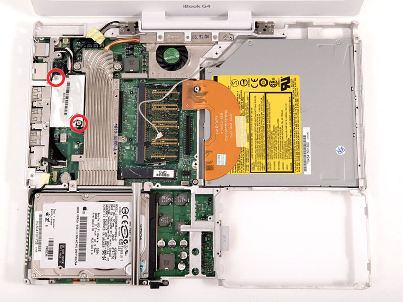

Add Note Edit Step 36 — Modem  ¶
  • Due to variations between iBook G4 models, your modem may look slightly different from the picture. All of the following steps apply to either model.
  • Remove the two Phillips screws at the corners of the modem.
first image
Add Note Edit Step 37  ¶
  • Lift the modem and modem shield from the bottom.
first image
Add Note Edit Step 38  ¶
  • Disconnect the RJ-11 cable from the top of the modem.
  • When replacing the modem, seat the shield first, and then connect the modem and press it firmly into the shield, making sure that it is connected to the logic board.
