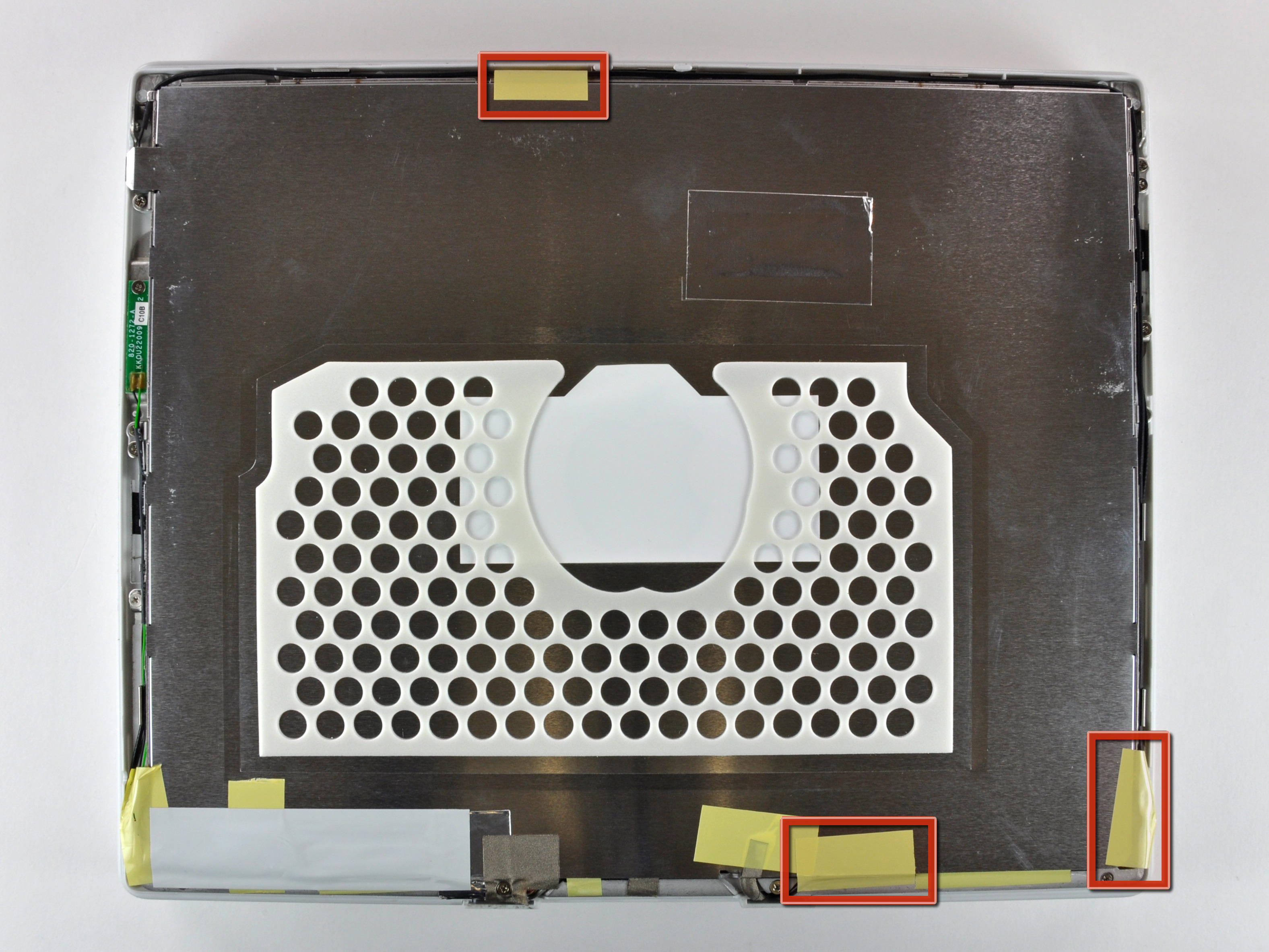

Add Note Edit Step 8  ¶
  • Lift the rear bezel off the display assembly.
