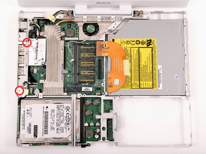

Add Note Edit Step 36 — I/O Bezel  ¶
  • Remove the two Phillips screws securing the white plastic fingers of the I/O bezel to the metal framework.
  • The longer screw goes into the longer finger, closer to the display.
first image
Add Note Edit Step 37  ¶
  • Lift up the left side of the computer and slide the I/O bezel away.
