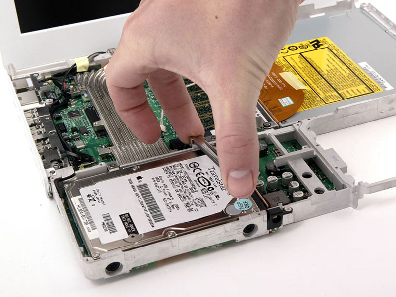

Add Note Edit Step 39 — Heat Sink  ¶
  • Lift the metal restraining bracket from the hard drive and place it aside.
first image
Add Note Edit Step 40  ¶
  • Remove the two Phillips screws securing the hard drive to the metal framework.
first image
Add Note Edit Step 41  ¶
  • Lift the hard drive up and remove the metal bracket, then carefully lower the hard drive back into its compartment.
first image
