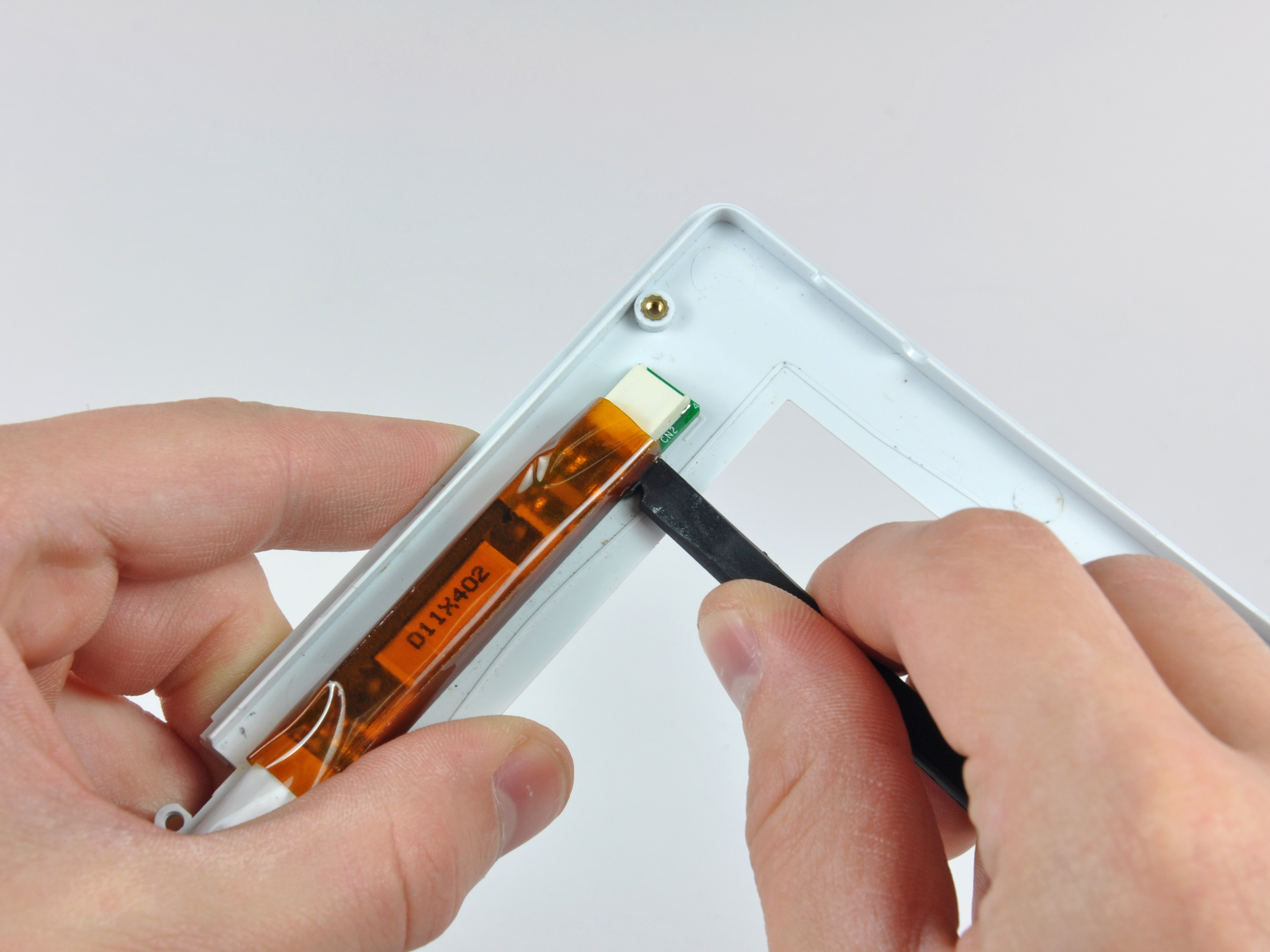

  • Use the tip of a spudger to lift the microphone out of the front bezel.
  • De-route the microphone cable from around the top and side of the display.

Add Note Edit Step 68 — Front Display Bezel  ¶
  • Insert the flat end of a spudger between the display inverter and the front display bezel near the center of the inverter.
  • Run the spudger along the length of the display inverter, separating it from the adhesive securing it to the front display bezel.
  • Lift the inverter out of the front display bezel.
first image
Add Note Edit Step 69  ¶
  • Front bezel remains.
