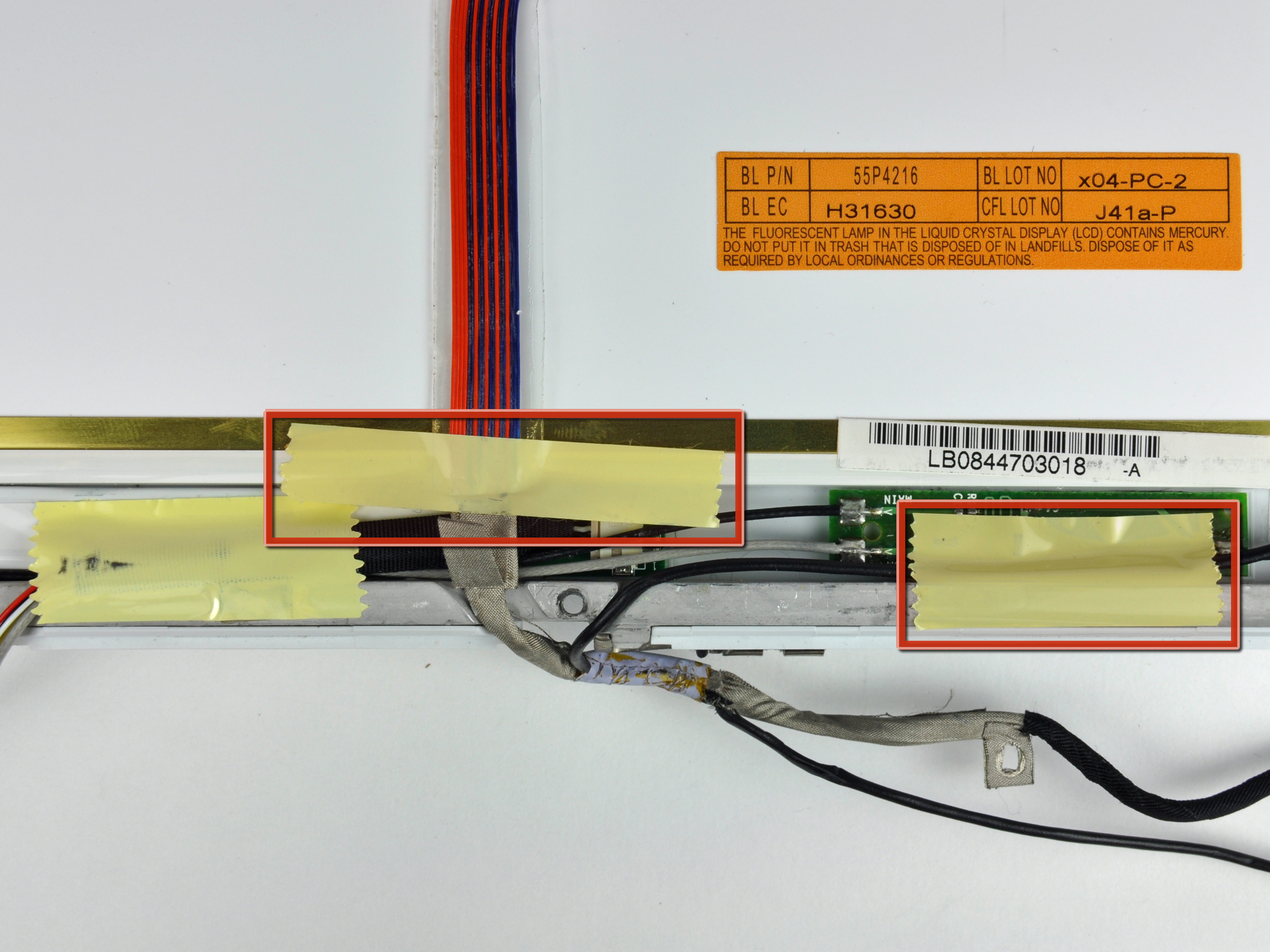

Add Note Edit Step 49 — LCD Cover  ¶
  • Remove the large piece of tape near the lower right corner of the display.
Image #1 Image #2
