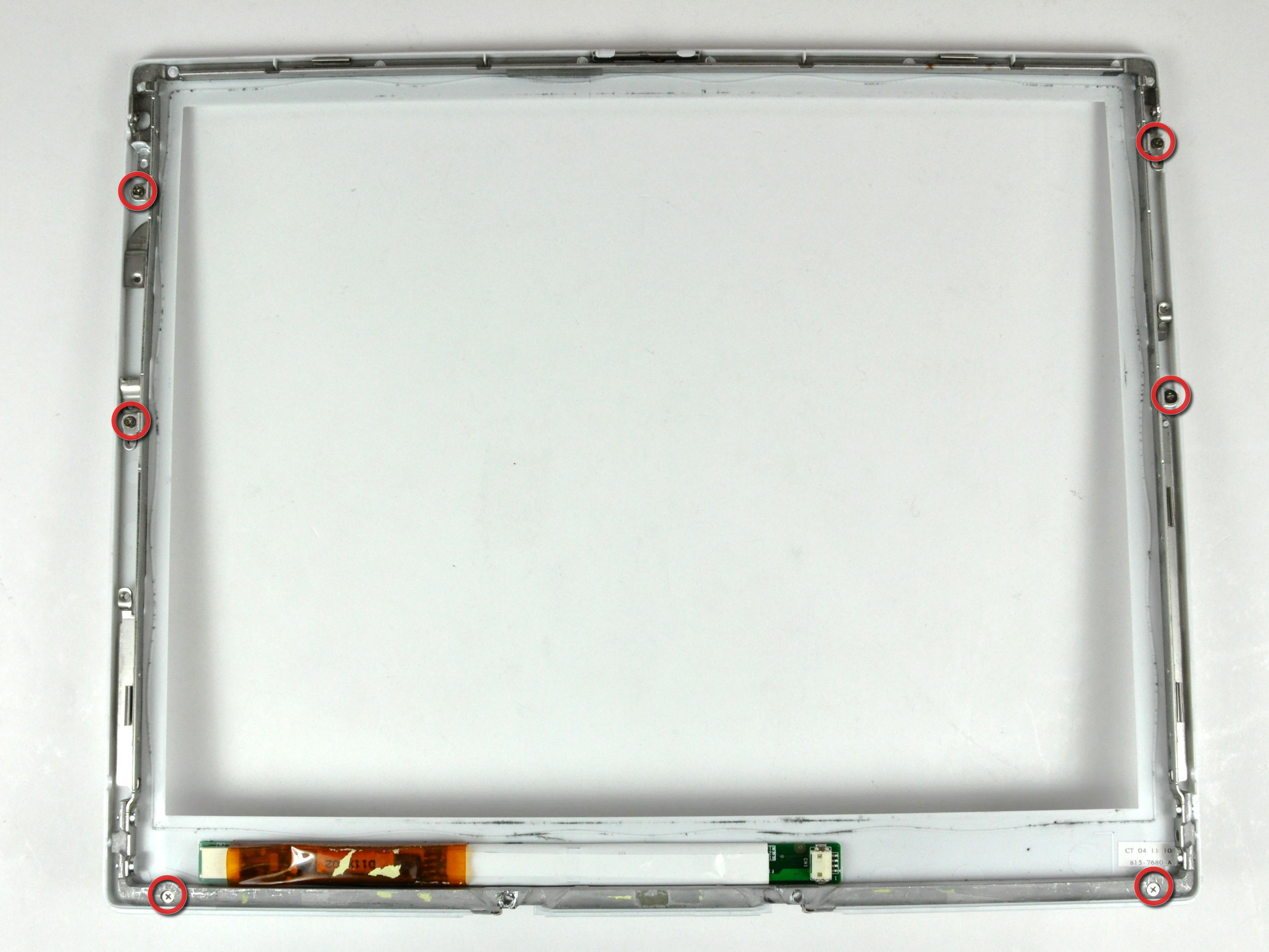

  • Remove the two Phillips screws securing each side of the LCD to the clutch hinge frame (four screws total).
first image
Add Note Edit Step 55  ¶
  • Lift the thin steel LCD cover off the LCD.
first image

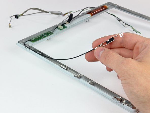

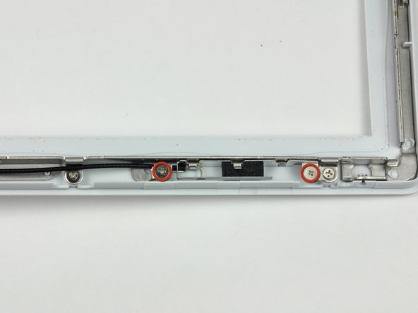

Add Note Edit Step 65  ¶
  • Remove the two Phillips screws securing the AirPort antenna to the front bezel.
  • De-route the AirPort antenna cable along the edge of the display.
first image
thumb image 1
thumb image 2

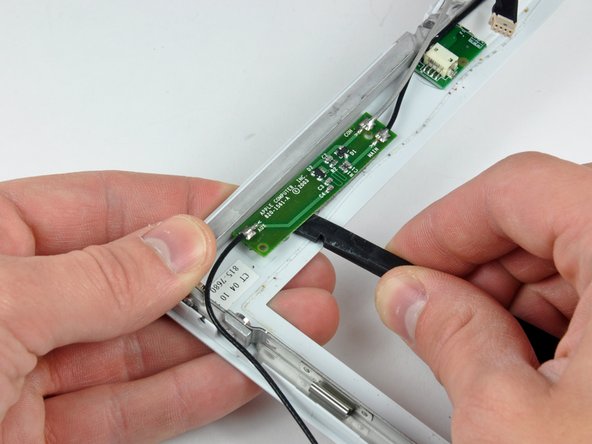

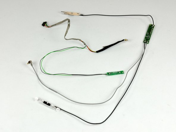

Add Note Edit Step 66  ¶
  • If you have a 1.33 GHz 12" G4 iBook, simply remove the Inverter/AirPort cables.
  • For all other models, use the flat end of a spudger to remove the antenna board from the front bezel.
  • The antenna board is very thin and delicate.
  • Remove the inverter/AirPort cables.

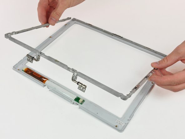

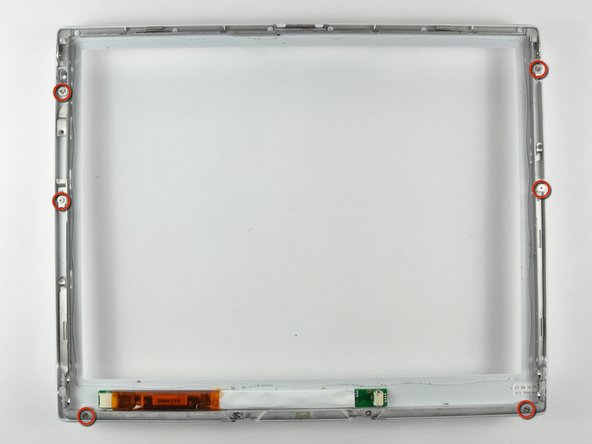

Add Note Edit Step 67 — Clutch Hinges  ¶
  • Remove the six Phillips screws securing the clutch hinges to the front display bezel.
  • Lift the clutch hinges off the front display bezel.
