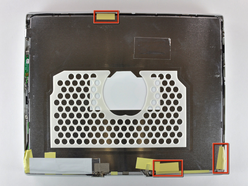

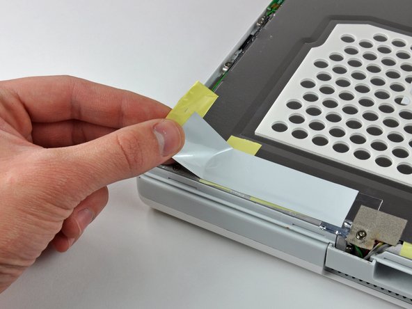

Add Note Edit Step 3  ¶
  • Insert the flat end of a spudger perpendicular to the face of the display into the gap between the front and rear bezels near the upper left corner of the display.
  • Rotate the spudger away from the display to pry the rear bezel off the front bezel.
