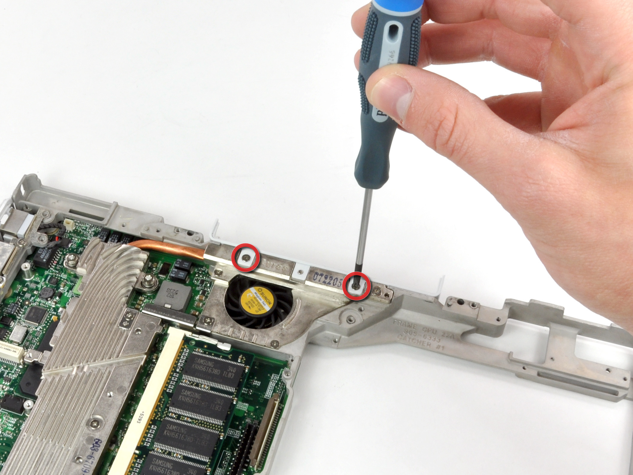

Add Note Edit Step 18 — Bottom Shield  ¶
  • Remove the following 4 screws from the bottom shield:
    • Two 3 mm Phillips.
    • Two 7.5 mm Phillips.
Image #1
Add Note Edit Step 19  ¶
  • Lift the bottom shield off.
Image #1
Add Note Edit Step 20 — DC-In Board  ¶
  • Remove the two Phillips screws securing the DC-In board, removing tape as necessary.
Image #1 Image #2
Add Note Edit Step 21  ¶
  • Deroute the cable from around the optical drive, removing tape as necessary.
  • Disconnect the DC-In cable from the logic board and angle the DC-In board out of its compartment.
Image #1
Add Note Edit Step 22 — Upper Case  ¶
  • Remove the two 3 mm Phillips screws inside the left edge of the battery tray.
Image #1
Add Note Edit Step 23  ¶
  • We recommend placing the computer on a soft cloth from this point on to prevent damaging the logic board.
  • Turn over the computer and open it.
  • Use the flat side of a flathead screwdriver to remove the small magnet covering a screw near the middle of the computer.
Image #1
Add Note Edit Step 24  ¶
  • Remove the following 7 screws from the edges of the keyboard area.
    • Three 2 mm Phillips along the right edge.
    • One 4.5 mm Phillips underneath where the magnet was.
    • One 6 mm Phillips with a small head in the lower left corner.
    • Two 6 mm Phillips with large heads, one in the upper left corner and one in the middle.
