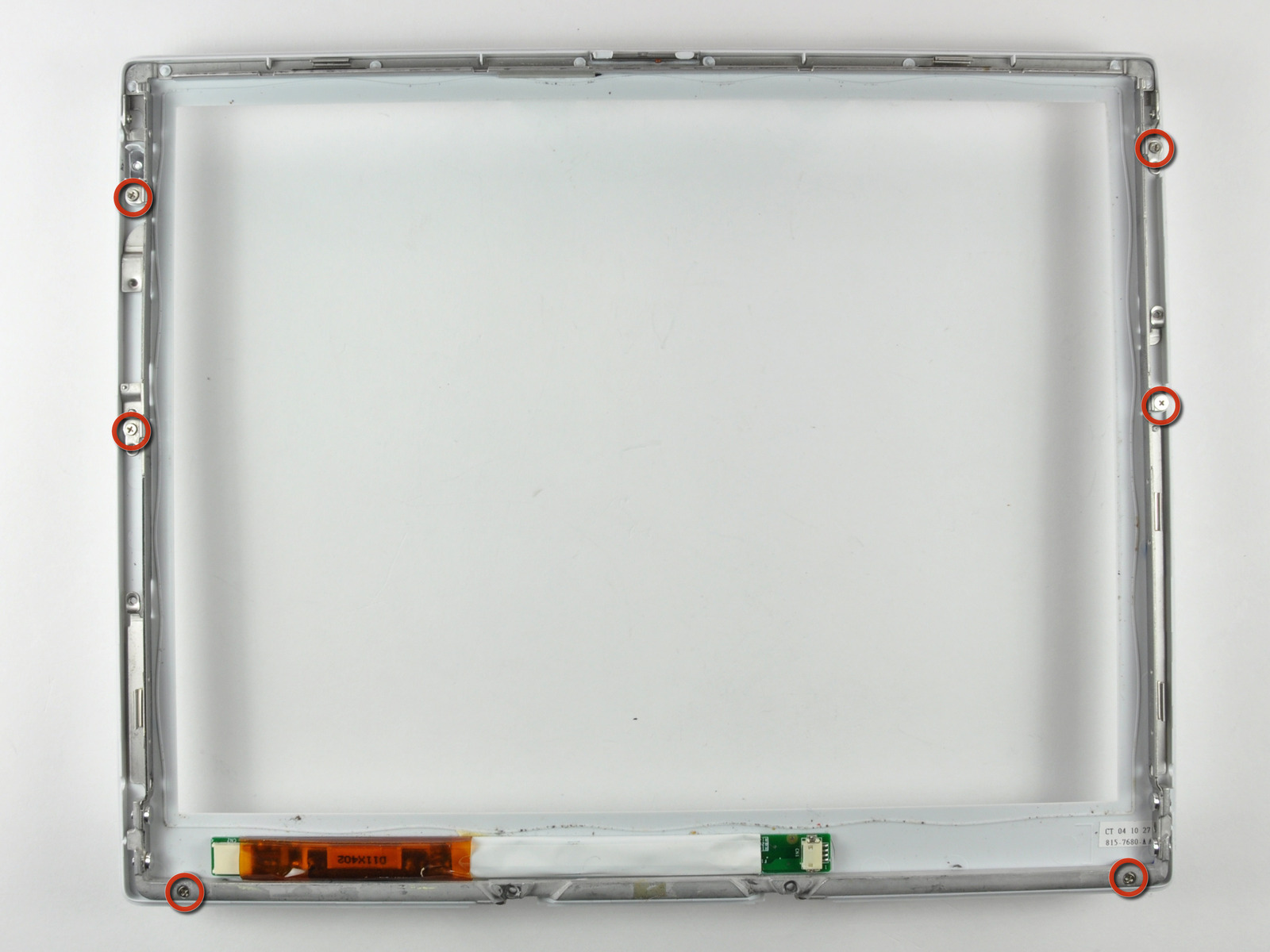

Image #1 Image #2
Add Note Edit Step 67 — Clutch Hinges  ¶
  • Remove the six Phillips screws securing the clutch hinges to the front display bezel.
  • Lift the clutch hinges off the front display bezel.
