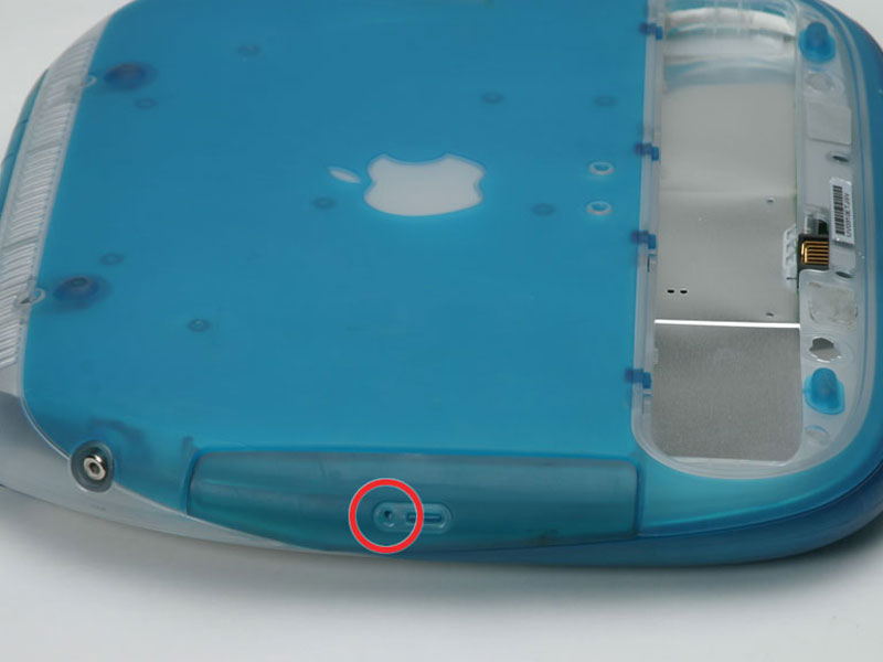

  • Use a coin to turn both battery locking screws 90 degrees to the left.
  • Remove the battery cover.
  • Remove the battery from the computer by pulling up on the plastic tab.
