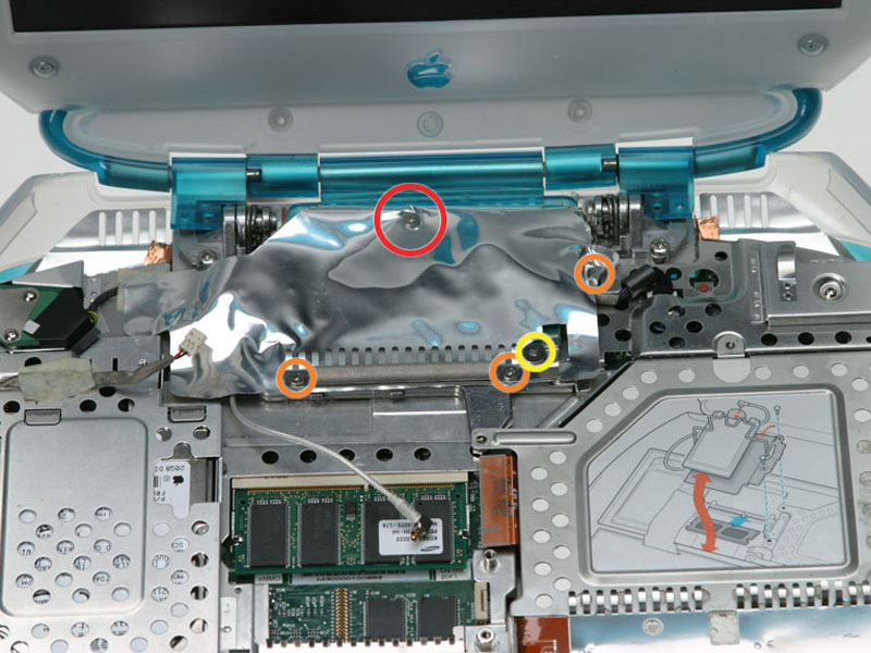

Add Note Edit Step 17 — Modem  ¶
  • Remove the following Phillips screws:
    • Remove the longer Phillips screw from the middle-rear of the modem shield.
    • Remove the three identical Phillips screws, two on either side of the EMI fingers, and the remaining one on the right side of the modem shield.
    • Remove the larger Phillips screw that secures the EMI fingers to the modem board.
  • Remove the EMI fingers.
first image
