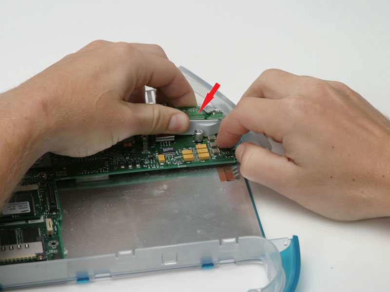

Add Note Edit Step 20 — Modem  ¶
  • Remove the following Phillips screws:
    • Remove the longer Phillips screw from the middle-rear of the modem shield.
    • Remove the three identical Phillips screws, two on either side of the EMI fingers, and the remaining one on the right side of the modem shield.
    • Remove the larger Phillips screw that secures the EMI fingers to the modem board.
  • Remove the EMI fingers.
Image #1
Add Note Edit Step 21  ¶
  • Peel the modem shield away from the metal framework below, working from the right front and moving to the left.
Image #1
Add Note Edit Step 22  ¶
  • Remove the Phillips screw from the left side of the modem.
  • Pry up the right side of the modem.
Image #1
Add Note Edit Step 23  ¶
  • Lift the modem partially out and disconnect the cable on the left side.
Image #1
Add Note Edit Step 24 — Display  ¶
  • Remove the Phillips screw from the left hinge.
  • Peel up the airport cable from beneath the yellow tape.
