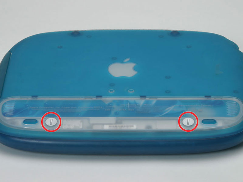

Easily swap out your laptop's battery.
first image
  • Use a coin to turn both battery locking screws 90 degrees to the left.
  • Remove the battery cover.
  • Remove the battery from the computer by pulling up on the plastic tab.
For more information, check out the iBook G3 Clamshell device page.
