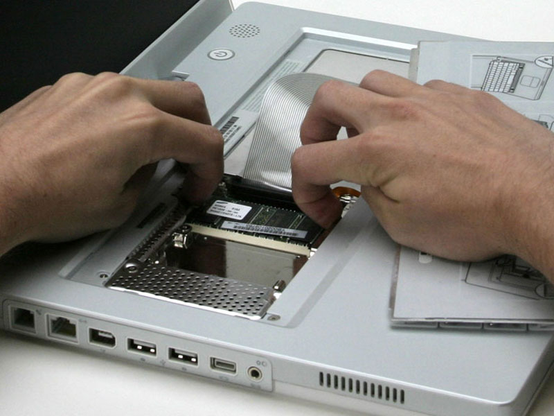

One RAM slot will accept PC100 or PC133 chips up to 512 MB.
Sections
Files
Tools
Image #1
  • Use a coin to rotate the battery locking screw 90 degrees clockwise.
Image #1
Add Note Edit Step 2 — Keyboard  ¶
  • Pull the keyboard release tabs (highlighted in red) toward you and lift up on the keyboard until it pops free.
  • If the keyboard does not come free, use a small flathead screwdriver to turn the keyboard locking screw 180 degrees in either direction and try again.
  • Flip the keyboard over, away from the screen, and rest it face-down on the trackpad area.
Image #1
Add Note Edit Step 3  ¶
  • If your computer does not have an AirPort card installed, skip to the RAM shield removal step.
  • Push the wire clasp toward the AirPort card and pull it up to free it from the RAM shield.
Image #1
Add Note Edit Step 4  ¶
  • Grasp the clear plastic tab on the AirPort card and pull toward the right.
Image #1
Add Note Edit Step 5  ¶
  • Hold the AirPort card in one hand and use your other hand to remove the antenna cable.
Image #1
Add Note Edit Step 6  ¶
  • Remove the two Phillips screws that secure the RAM shield.
Image #1
Add Note Edit Step 7  ¶
  • Grasp the metal bracket on top of the RAM shield and pull upward to remove the shield.
Image #1
Add Note Edit Step 8  ¶
  • Pull the keyboard cable up from the logic board, holding the cable as close to the connector as possible.
