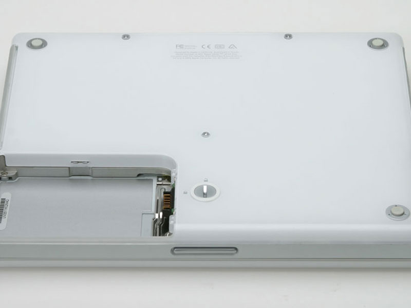

Replacing the plastic bottom case.
first image
  • Use a coin to rotate the battery locking screw 90 degrees clockwise.
first image
Add Note Edit Step 2 — Lower Case  ¶
  • Your laptop should look approximately like this.
first image
