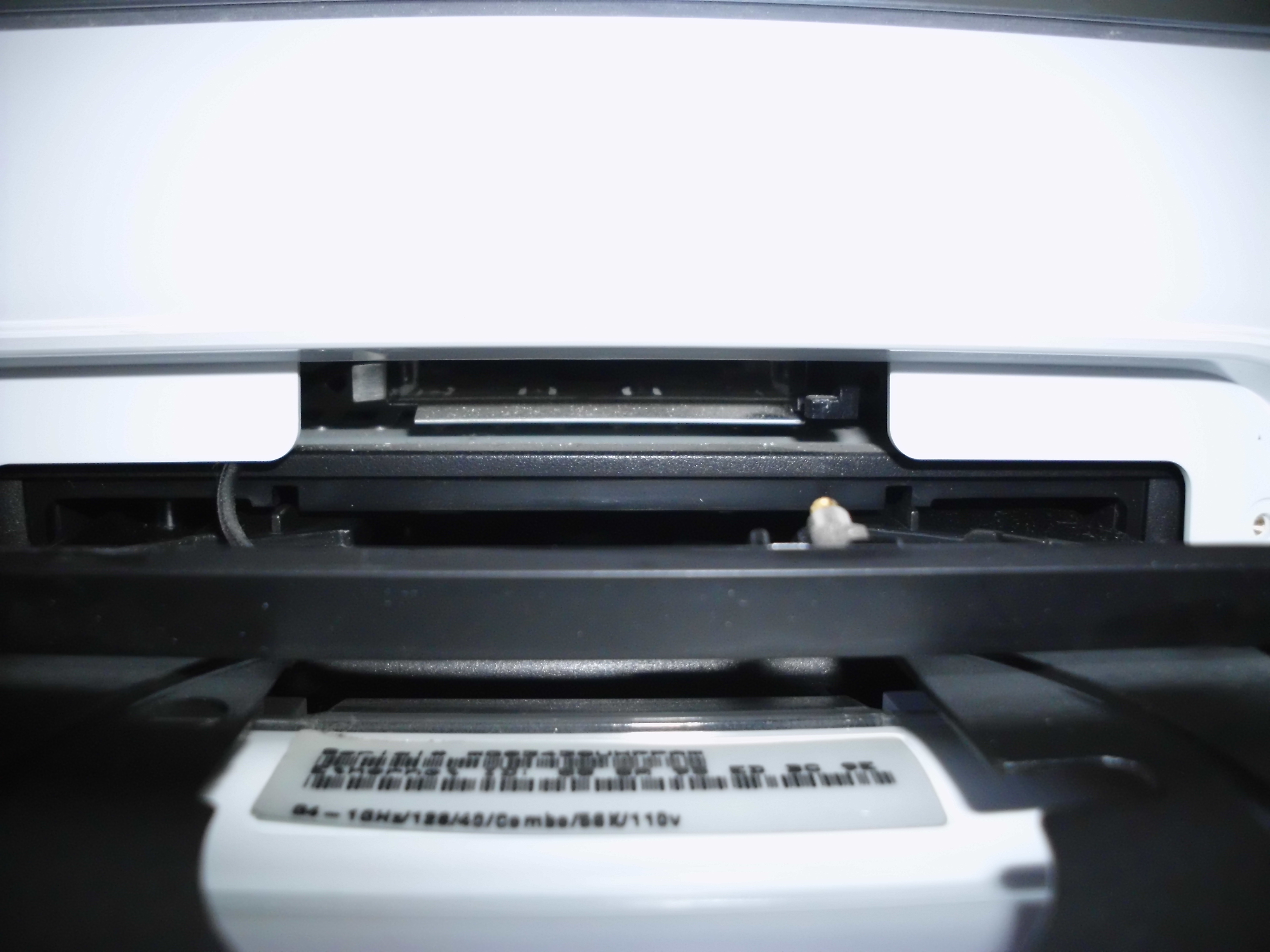

  • Installation of the AirPort Card on this machine is very easy.
  • The AirPort slot is located just above the Optical Drive in the front of the unit. It is covered by a small plastic panel.
Image #1 Image #2

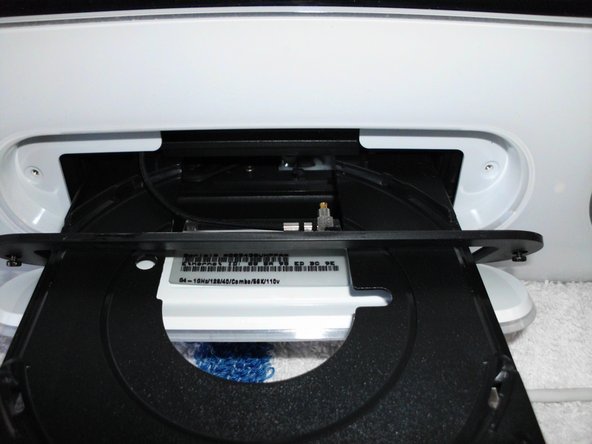

Add Note Edit Step 2  ¶

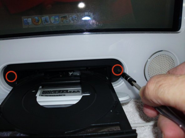

  • Press the eject arrow located on the upper right corner of your keyboard. Once the optical drive tray is open, gently hold it and shut down the machine.
  • Remove the two Phillips screws located to the right and left sides of the optical drive tray.
  • The Airport cable is snapped into place on the back of the optical drive panel .
  • Gently remove the panel from the front of the eMac
  • Disconnect the AirPort cable from the optical drive panel.
  • Pull the AirPort card straight away from its socket in the eMac.
