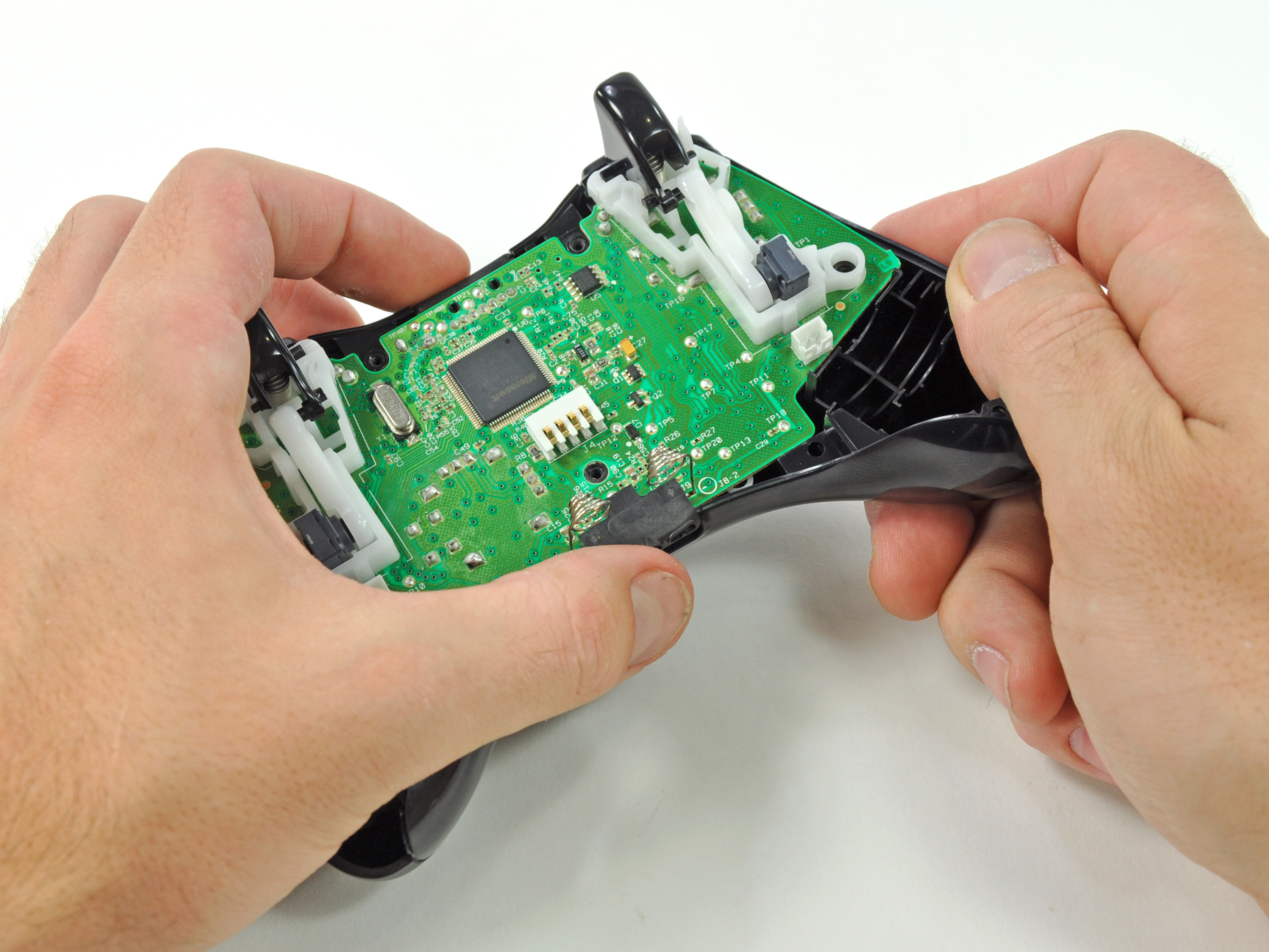

Add Note Edit Step 6  ¶
  • Grasp the controller by the battery compartment and the headphone jack.
  • Lift the battery compartment away from the headphone jack, separating the rear case from the front case and logic board.
  • The battery contact springs are held in place by slots in the battery housing in the rear case. Be sure to re-align them properly during reassembly.
Image #1 Image #2
Add Note Edit Step 7 — Vibration Motors  ¶
  • Use the flat end of a spudger to remove the vibration motor cable upwards from its socket on the logic board.
  • Lift the vibration motor out of the front case.
Image #1 Image #2
Add Note Edit Step 8  ¶
  • Remove the vibration motor from the other side of the controller using the same method previously described.
  • The right motor has significantly more counter-weight than the left motor.
