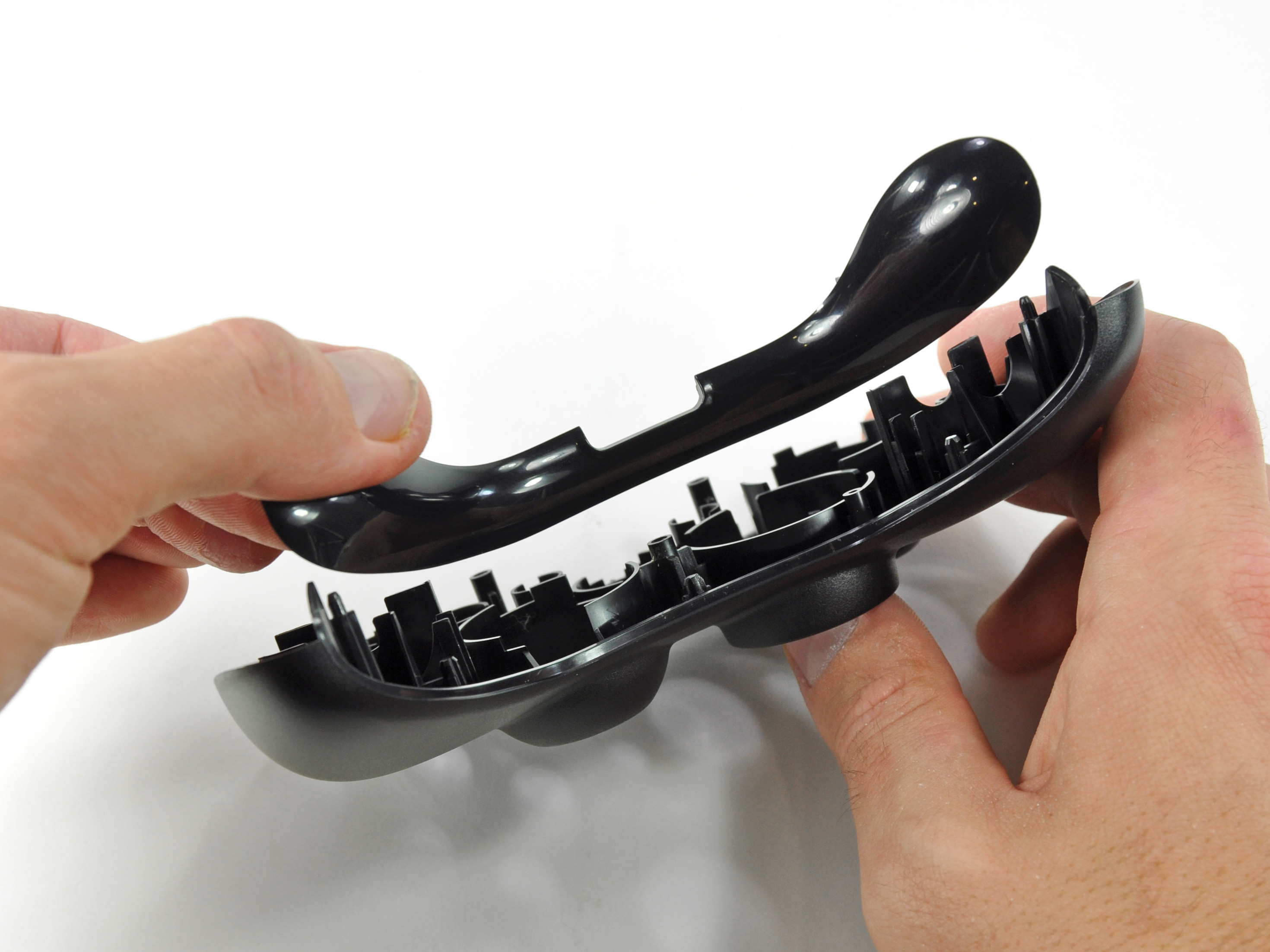

Use this guide to replace the bottom panel of your controller that you cracked by throwing it at the TV.
Image #1 Image #2
  • Depress the battery release button on the top of the controller.
  • Remove the battery holder from the controller.
  • The standard option for Xbox 360 Wireless Controllers Battery Packs is AA batteries inside the battery holder. A rechargeable battery is available also, but both options are removed from the controller in the same way.
Image #1
Add Note Edit Step 2 — Rear Case  ¶
  • Use a pair of tweezers to peel the barcode sticker from the battery compartment.
Image #1
Add Note Edit Step 3  ¶
  • Remove the seven 9.3 mm T8 Security Torx screws securing the rear case to the front case.
Image #1 Image #2
Add Note Edit Step 4  ¶
  • Insert a spudger between the front and rear cases along the left edge of the controller.
  • Rotate the spudger toward the front of the controller, prying the two cases apart.
Image #1 Image #2
Add Note Edit Step 5  ¶
  • Insert a spudger between the front and rear cases, near the headphone jack.
  • Rotate the spudger toward the front of the controller to pry the two cases apart.
Image #1 Image #2
Add Note Edit Step 6  ¶
  • Grasp the controller by the battery compartment and the headphone jack.
  • Lift the battery compartment away from the headphone jack, separating the rear case from the front case and logic board.
  • The battery contact springs are held in place by slots in the battery housing in the rear case. Be sure to re-align them properly during reassembly.
Image #1 Image #2
Add Note Edit Step 7 — Vibration Motors  ¶
  • Use the flat end of a spudger to remove the vibration motor cable upwards from its socket on the logic board.
  • Lift the vibration motor out of the front case.
Image #1 Image #2
Add Note Edit Step 8  ¶
  • Remove the vibration motor from the other side of the controller using the same method previously described.
  • The right motor has significantly more counter-weight than the left motor.
