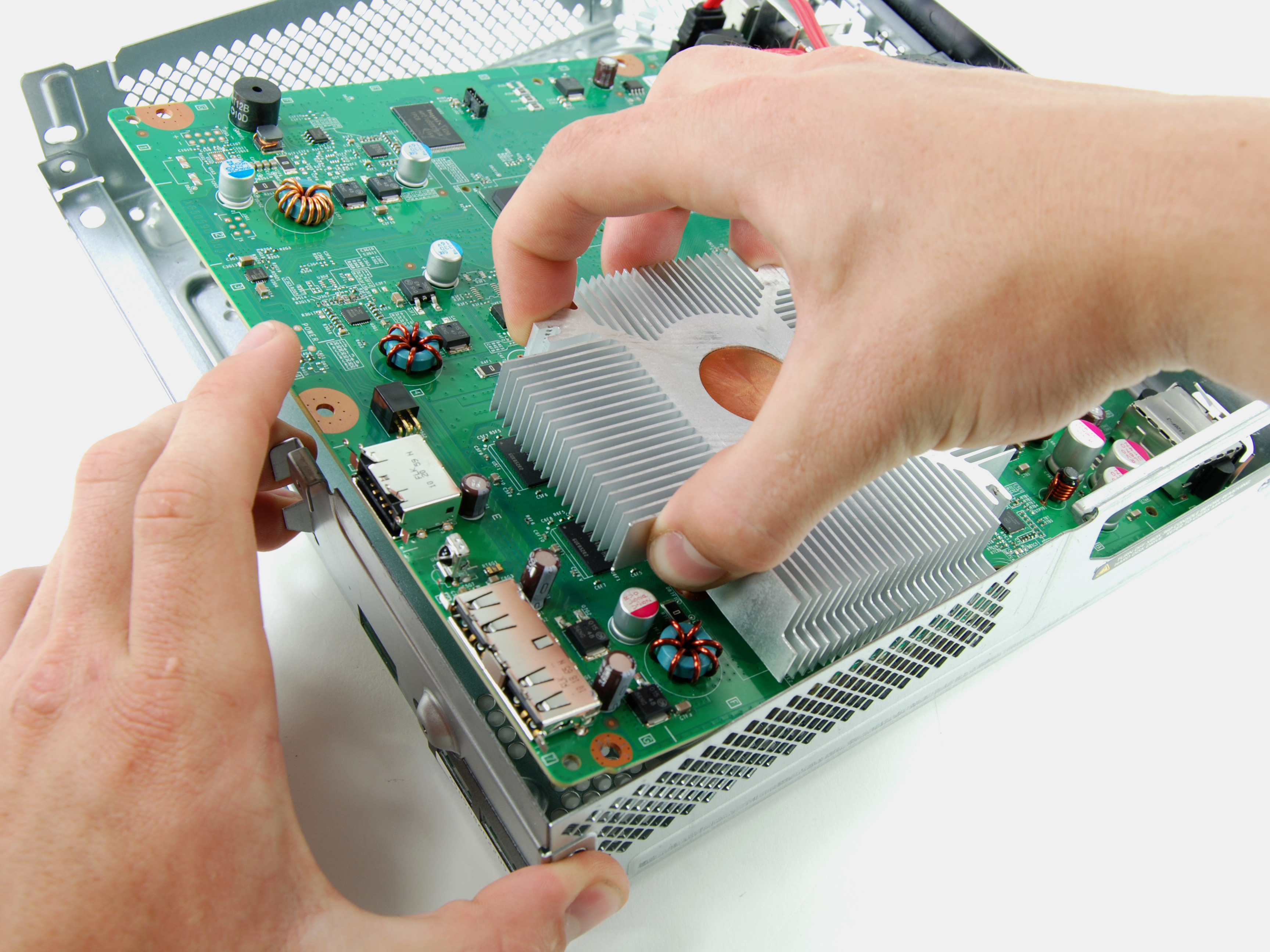

Installing Xbox 360 S Motherboard
Prerequisite Only
Prerequisite Only
Please note that this guide is only a prerequisite for other guides.
A prerequisite to removing the heat sink.
A brief summary of what you are doing
Image #1
Add Note Edit Step 1 — Top Panel  ¶
  • In the following steps, you will remove the top vent, secured to the top panel by the thirteen clips shown.
  • Take care when removing the fan vent not to break any of the plastic clips.
Image #1 Image #2
Add Note Edit Step 2  ¶
  • Orient the console so that the words "XBOX 360" on the sides are right-side up, and the faceplate is facing to the left.
  • Insert a metal spudger between the top vent and the top bezel near the rear of the Xbox.
  • Rotate the spudger away from the console, prying the edge of the fan vent up until the two plastic clips come free.
  • Be sure to rotate the spudger far enough so that the plastic clips clear the silver rim of the top bezel.
Image #1 Image #2 Image #3
Add Note Edit Step 3  ¶
  • Insert a metal spudger between the fan vent and top bezel along the left side of the console.
  • In the same manner described above, begin prying the left side of the top vent away from the top bezel.
  • Continue prying along the left side of the device, freeing all the clips on that side.
Image #1 Image #2
Add Note Edit Step 4  ¶
  • Lift the fan vent up from the freed left side to disengage the clips along the right side.
  • Remove the entire fan vent.
Image #1 Image #2
Add Note Edit Step 5  ¶
  • In the following steps, you will be releasing the six clips highlighted in red.
  • Each clip can be undone by inserting a metal spudger underneath the bottom edge of the clip. Once underneath the bottom edge, simply prying away from the console will free the clip.
Image #1 Image #2
Add Note Edit Step 6  ¶
  • Orient the console so that the left case is facing toward you and the faceplate is facing toward the right.
  • Insert a metal spudger through the front-most slit on the left edge of the top bezel and between the bottom edge of the clip and the left case, as described above.
  • Simultaneously rotate the spudger away from the console and pull up on the top bezel to free the clip.
  • You will hear a "pop" signifying that the clip cleared its catch.
Image #1 Image #2
Add Note Edit Step 7  ¶
  • Using the same method described above, free the two remaining clips along the left edge of the top bezel.
Image #1
Add Note Edit Step 8  ¶
  • Grab the entire top panel with your hands, lift up the entire left edge high enough to rest the separated clips on top of the left case.
  • You may have to go back with a spudger and undo any clips that have re-attached.
  • The top panel will not come free of the console yet.
