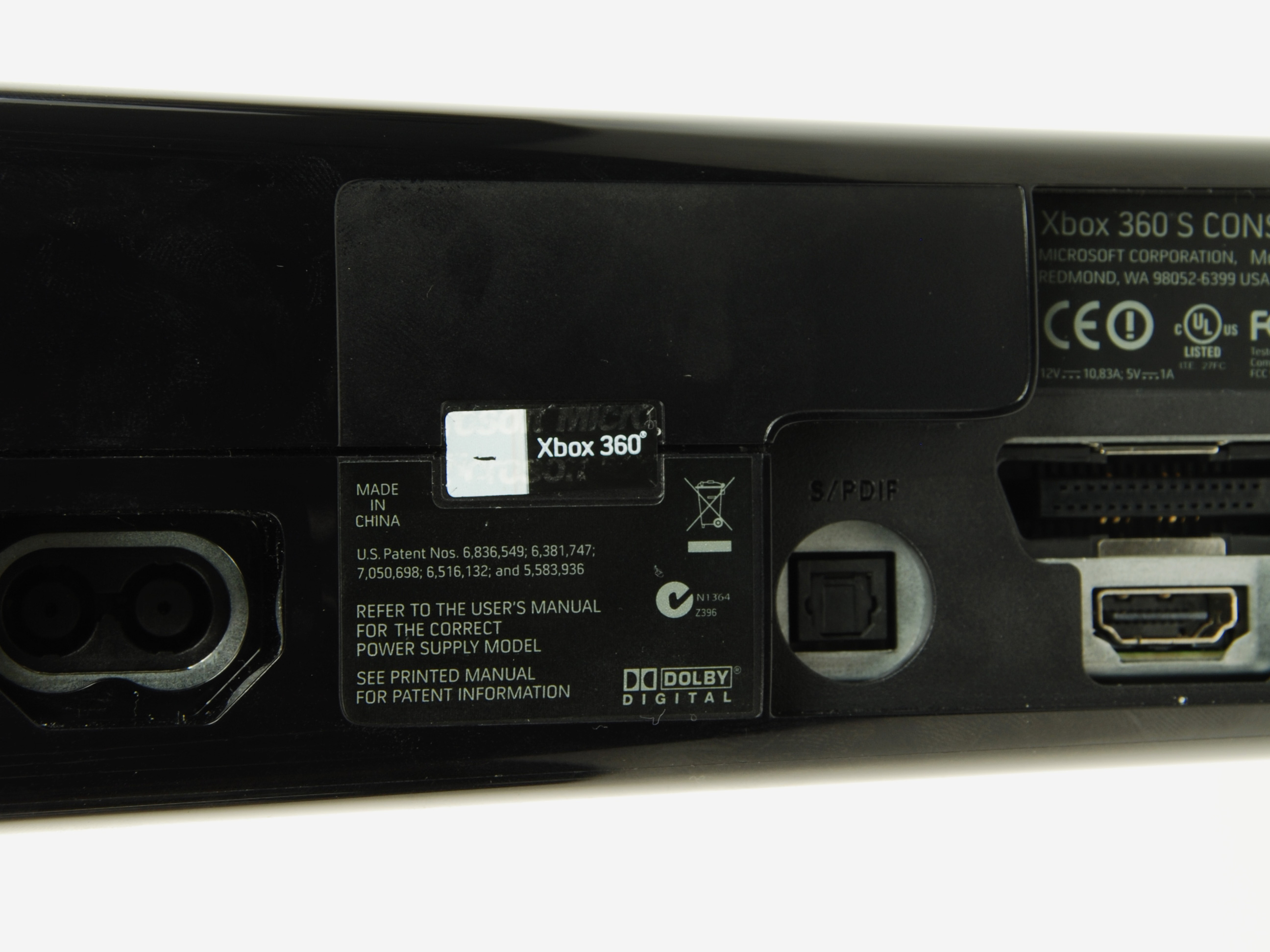

  • Orient the Xbox 360 S so that the bottom of the console is facing toward you.
  • Push the latch holding down the hard drive cover to the left.
  • Pull the hard drive cover away from the console.
