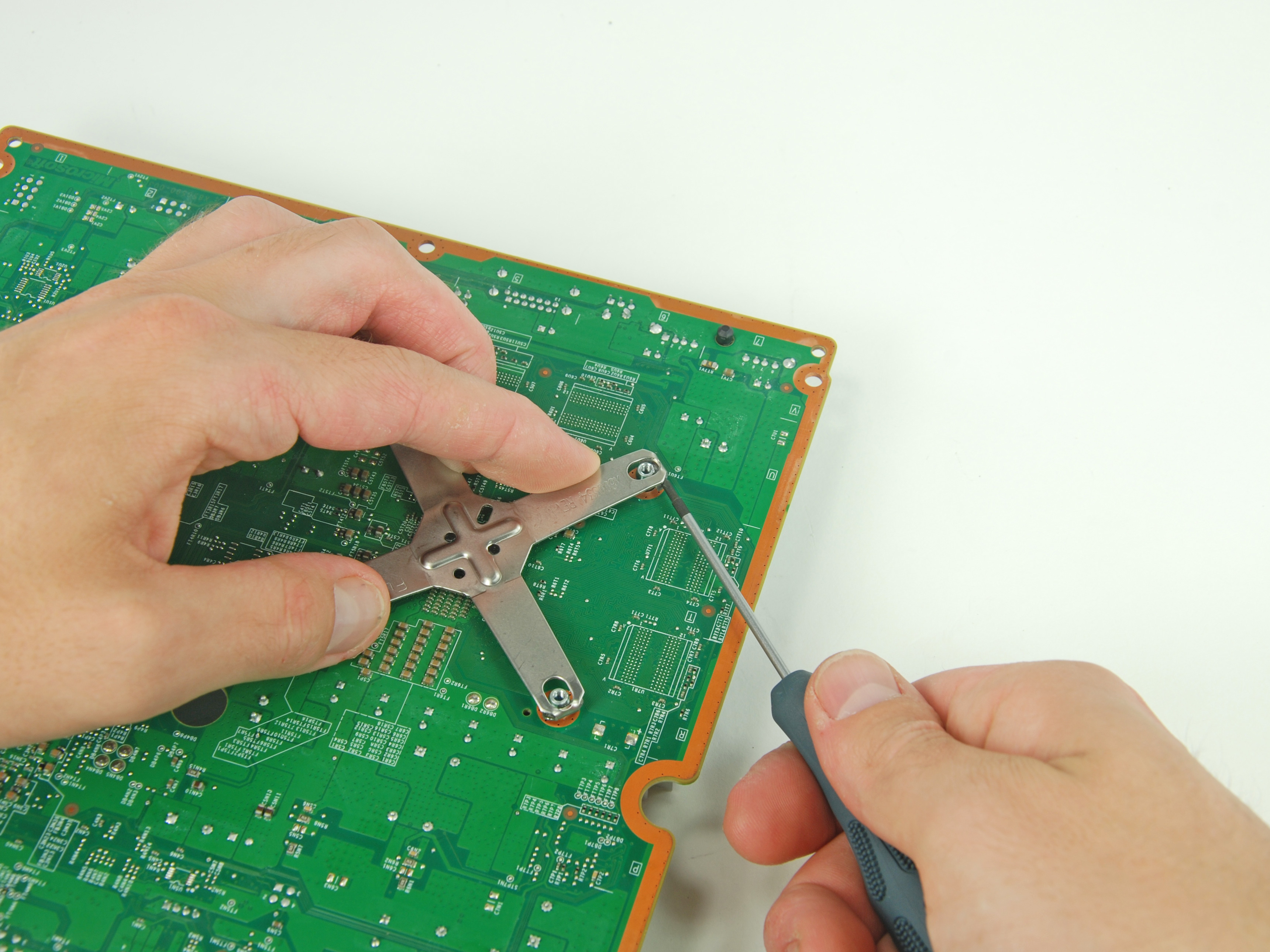

Older Xbox 360 models had major issues with the heat sink. Replace your heat sink in the (hopefully unlikely) event of RROD deja vu.

Add Note Edit Step 5  ¶
  • In the following steps, you will be releasing the six clips highlighted in red.
  • Each clip can be undone by inserting a metal spudger underneath the bottom edge of the clip. Once underneath the bottom edge, simply prying away from the console will free the clip.
Image #1 Image #2
