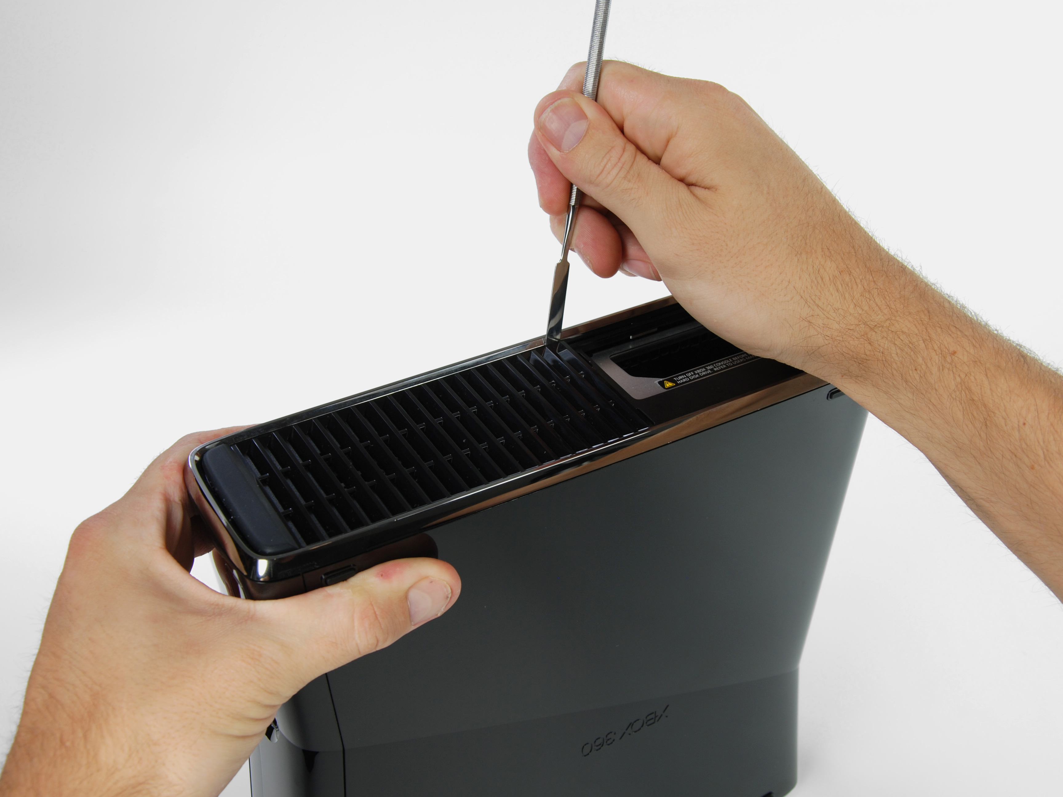

Add Note Edit Step 4  ¶
  • Orient the Xbox 360 S so that the hard drive port is facing up and the faceplate is facing to the left.
  • Insert a metal spudger between the black bottom vent and the silver rim of the bottom bezel, in the rear right corner of the vent.
  • Rotate the spudger away from the console, prying the vent up from the bottom bezel.
  • Be sure to rotate the spudger far enough so that the clips on the vent are lifted past the silver rim of the bottom bezel.
Image #1 Image #2 Image #3
Add Note Edit Step 5  ¶
  • In the same manner as described above, pry the two remaining clips on the bottom right edge.
  • All of the clips along both the right and front edge should now be free. If other clips have come undone as well, that is fine.
