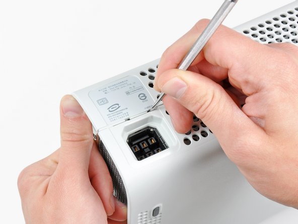

  • If you do not have an Xbox 360 opening tool, skip to the next step.
  • Press the Xbox 360 opening tool down into the two remaining clips near the power connector.
  • Push the upper and lower cases apart to fully release the retaining clips.

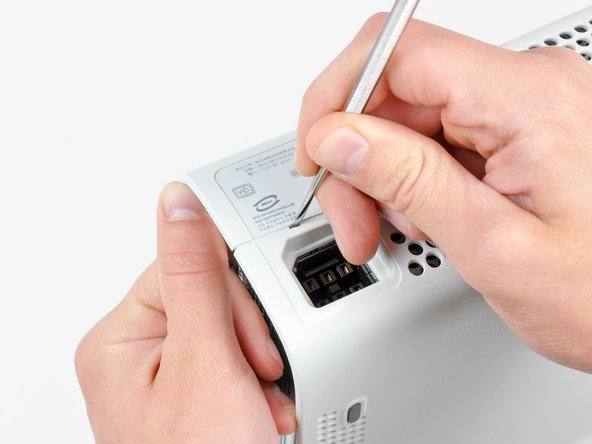

  • If you used an Xbox 360 opening tool on the previous step, skip this step.
  • Release the latches located above the power connector using the same procedure as previously noted.
