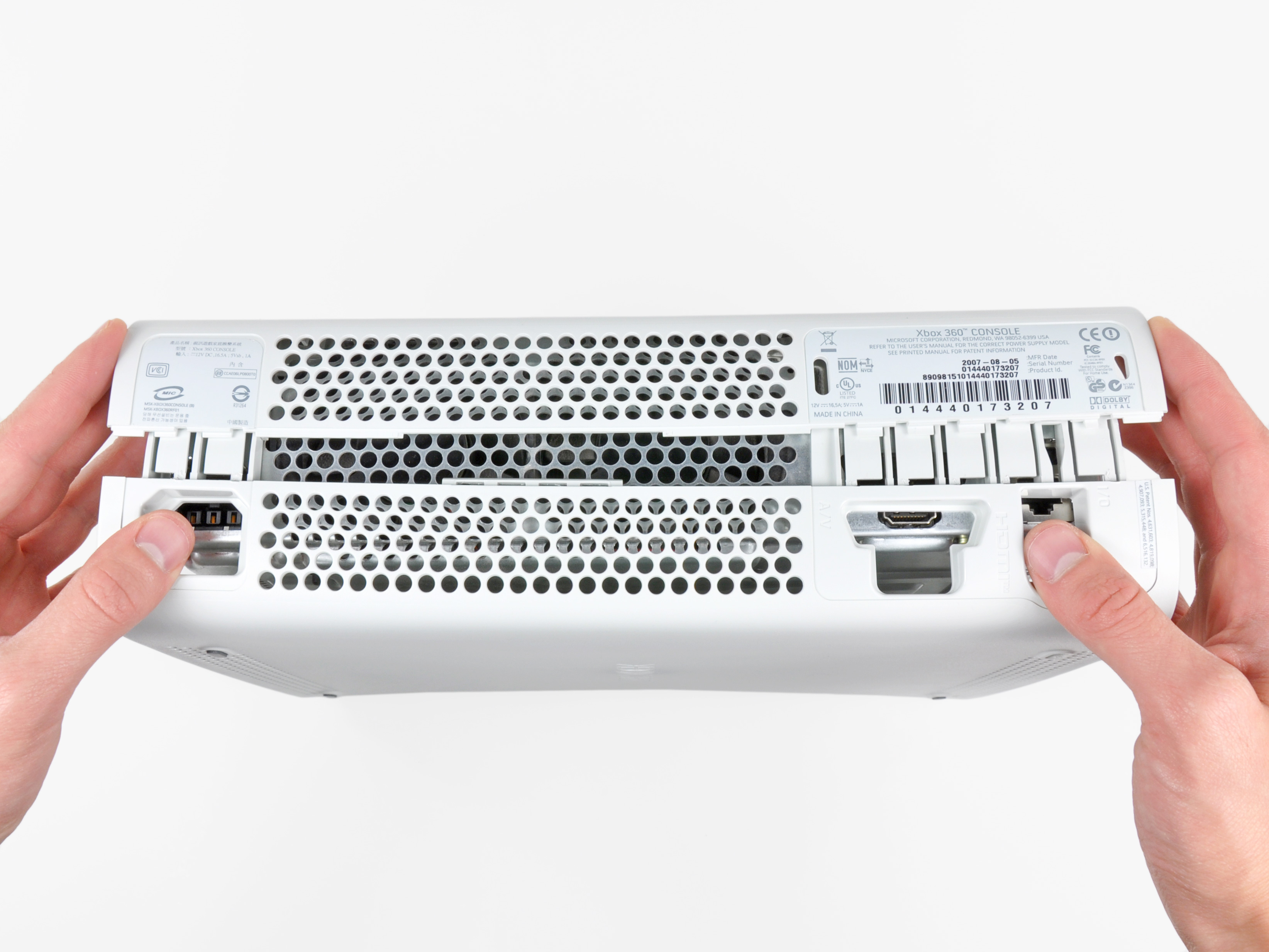

Add Note Edit Step 2 — Bottom Vent  ¶
  • Stand the console vertically with the bottom edge facing up.
  • Throughout the following opening procedure, the finger of an Xbox 360 opening tool can be used in place of a spudger.
  • Insert the flat end of a spudger or the edge of an Xbox 360 opening tool into the small gap at the front edge of the bottom vent.
  • Pry the front edge of the bottom vent away from the faceplate.

Add Note Edit Step 7  ¶
  • Remove the bottom vent from the 360.
Image #1 Image #2
