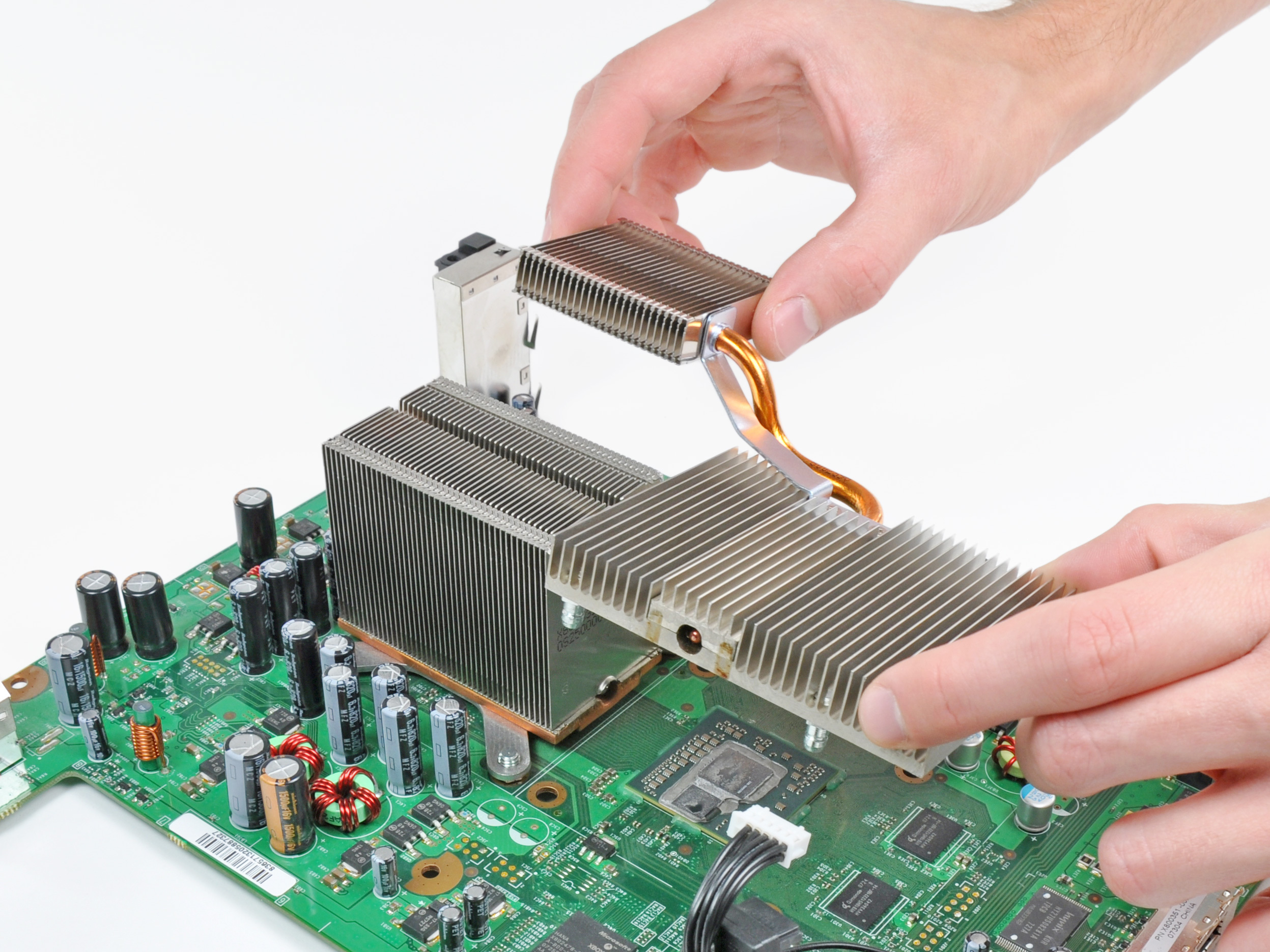

Add Note Edit Step 43 — GPU Heat Sink  ¶
  • Insert the tip of a small flathead screwdriver between the X clamp and its retaining post on the heat sink.
  • Pry the X clamp away from its retaining post until it is lifted above the small groove cut into the retaining post.
first image
thumb image 1
thumb image 2
Add Note Edit Step 44  ¶
  • Insert your screwdriver parallel to the motherboard between the X clamp and its retaining post.
  • Twist the screwdriver to fully release the X clamp from its retaining post.
  • Repeat this process for all four corners of the X clamp.
  • When removing the last corner of the X clamp and holding the motherboard upside down, be sure to catch the GPU heat sink to avoid damage from it falling.

first image
Add Note Edit Step 46  ¶
  • Remove the GPU heat sink.
  • Before reinstalling the GPU heat sink, be sure to apply a new layer of thermal paste.
  • If you need to mount the heat sink back onto the motherboard, we have a thermal paste guide that makes replacing the thermal compound easy.
