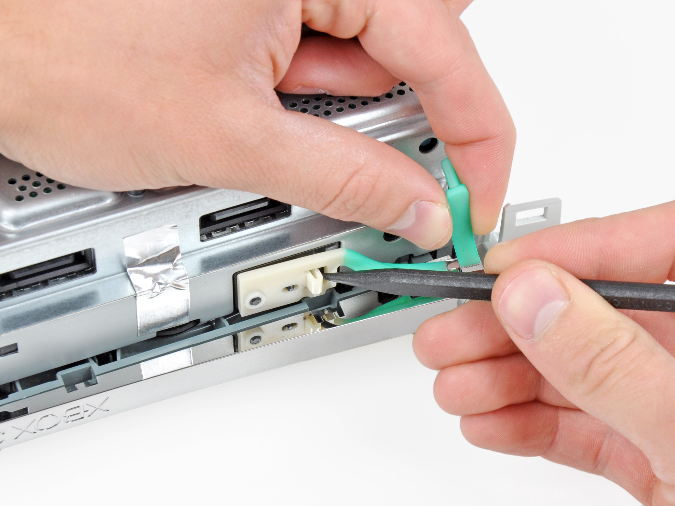

Add Note Edit Step 11 — Top Vent  ¶
  • Stand the console vertically with the top edge facing up.
  • The top vent is secured to the console via clips. The first two clips are located underneath the top vent closest to the faceplate, as shown in the pictures.
Image #1 Image #2
Add Note Edit Step 12  ¶
  • Insert the flat end of a spudger into the small gaps previously mentioned to release the clips.
  • You may also use the long finger of an Xbox 360 opening tool to accomplish this task.
