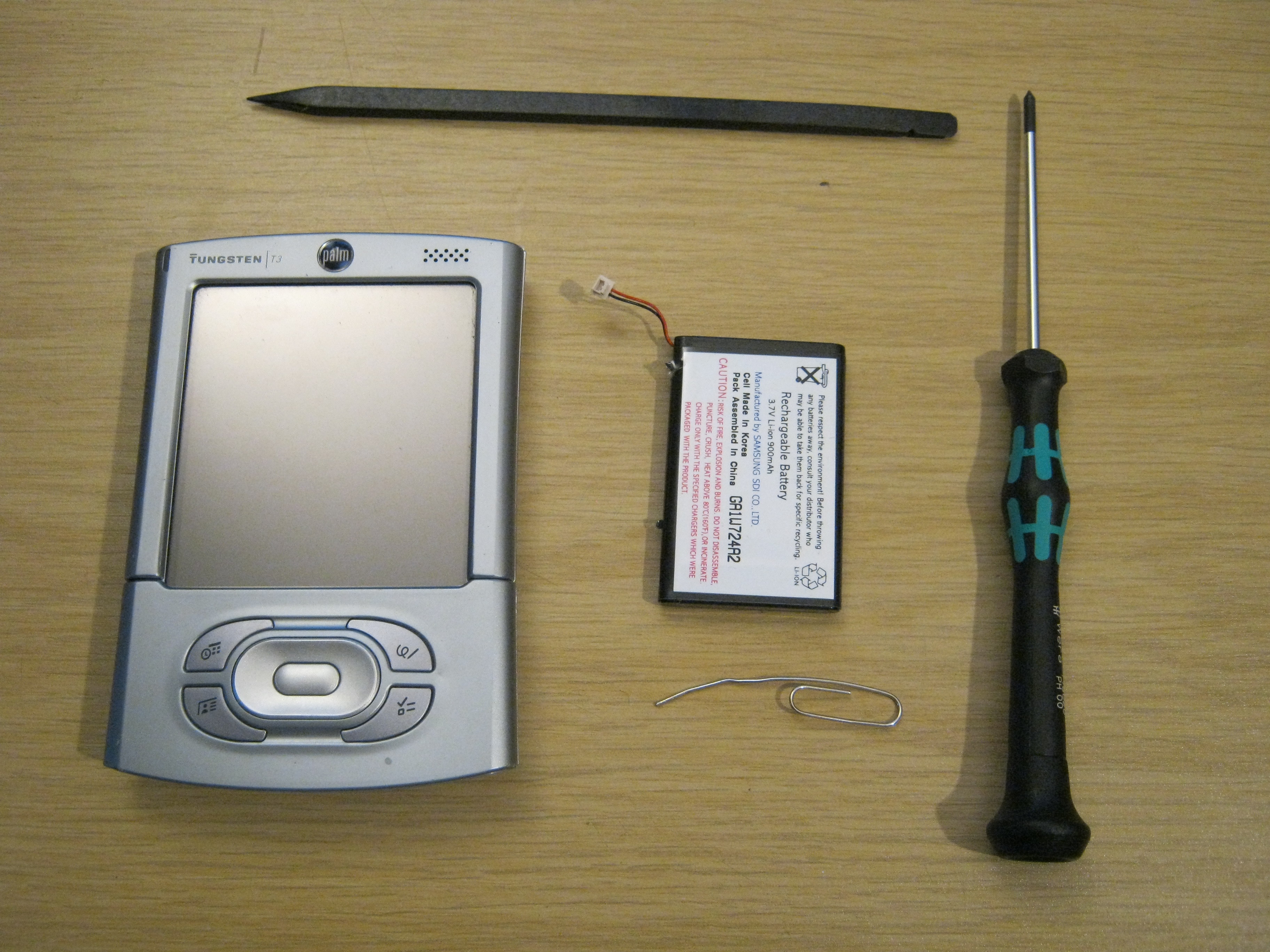

Replace the battery in your Tungsten T3.
  • Author: Whitney
  • Time required: 5 to 10 minutes
  • Difficulty: Easy
This guide will take you step by step through the process of replacing the battery in the Palm Tungsten T3.

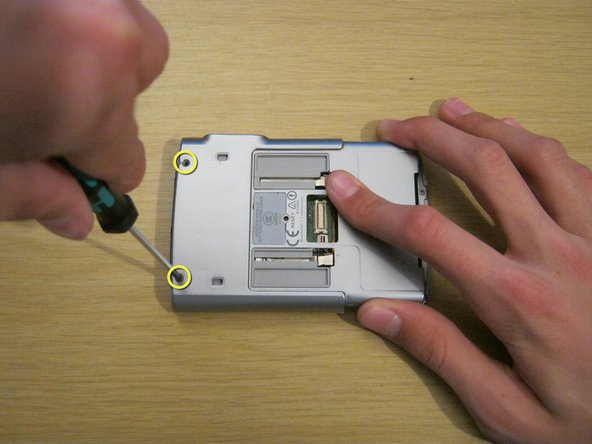

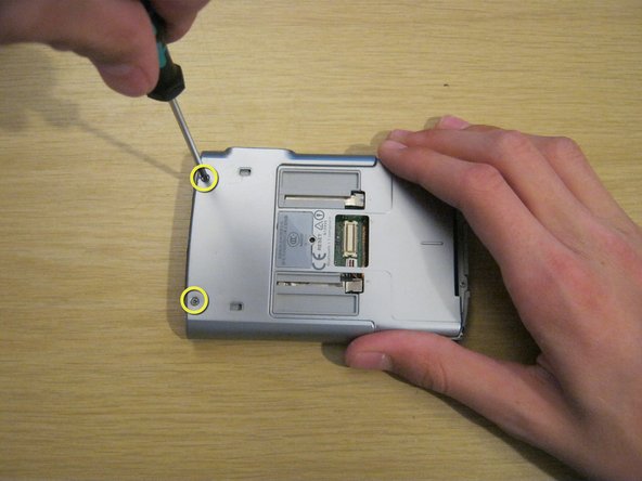

  • Unscrew the two Phillips #00 screws on either side of the device, on the sliding handwriting panel.
