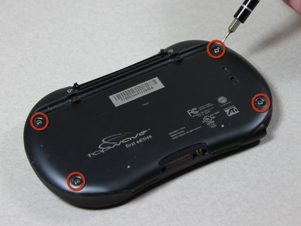

  1. Tapwave T2907US Zodiac 2 Touchscreen/Display Replacement, Back Cover: step 1, image 1 of 1
    • Remove the four Torx T5 screws from the back panel.

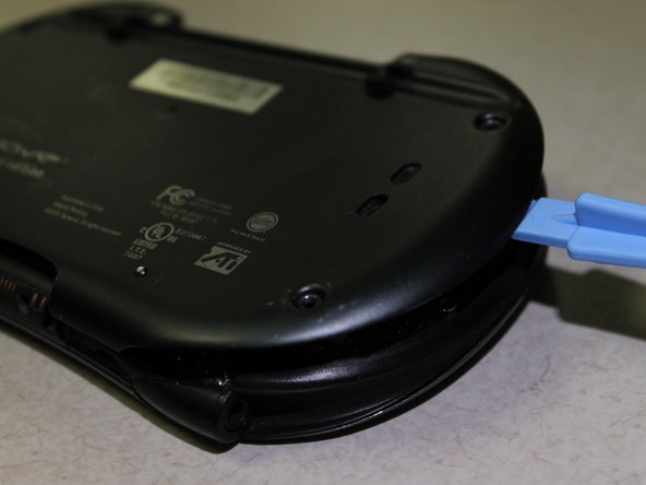

  2. Tapwave T2907US Zodiac 2 Touchscreen/Display Replacement: step 2, image 1 of 1
    • Wedge a spudger in between the front and back panel.
    • Apply leverage downwards to the spudger in order to remove the back panel.

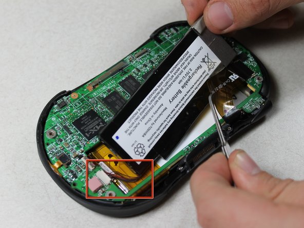

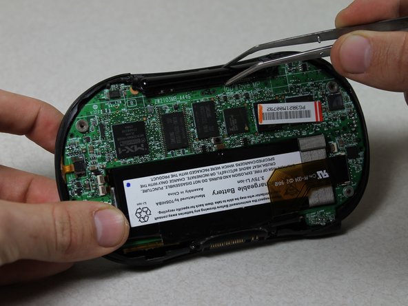

  3. Tapwave T2907US Zodiac 2 Touchscreen/Display Replacement, Battery: step 3, image 1 of 1
    • Slide the battery out from under the brown wire-tape.
    • Be careful of the wires still connected to the other end of the battery. Do not pull or damage may occur.

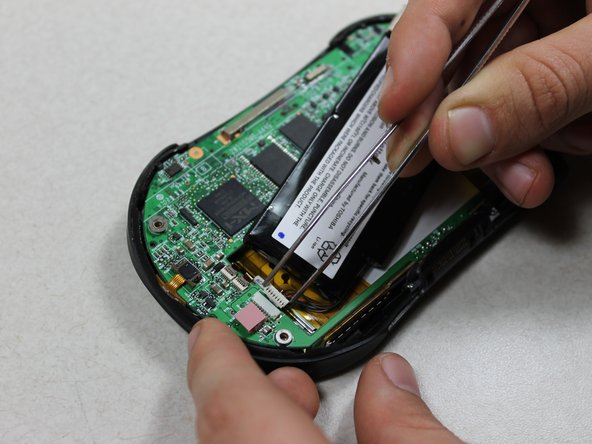

  4. Tapwave T2907US Zodiac 2 Touchscreen/Display Replacement: step 4, image 1 of 1
    Tool used on this step:
    Buy
    • Slowly pull the white plug from its receptor. Grasp its sides firmly with a pair of tweezers and gently wiggle from side to side.

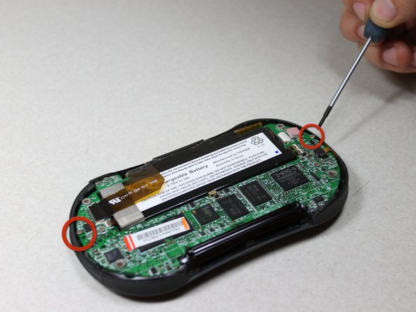

  5. Tapwave T2907US Zodiac 2 Touchscreen/Display Replacement, Motherboard: step 5, image 1 of 1
    • Unscrew the 2 Philips #00 screws on each end of the motherboard.

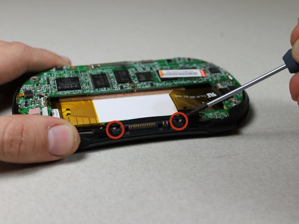

  7. Tapwave T2907US Zodiac 2 Touchscreen/Display Replacement: step 7, image 1 of 1
    • Unscrew the 2 Philips #00 screws on each side of the charging port.

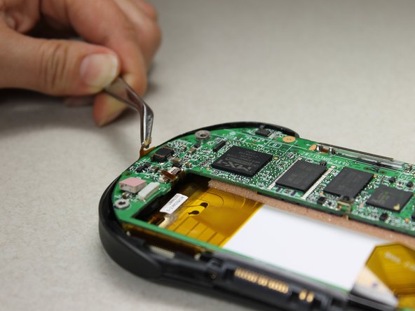

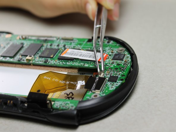

  8. Tapwave T2907US Zodiac 2 Touchscreen/Display Replacement: step 8, image 1 of 2 Tapwave T2907US Zodiac 2 Touchscreen/Display Replacement: step 8, image 2 of 2
    • Disconnect 2 brown wire-tape ends from each end of the motherboard. Gently pull straight out with tweezers.

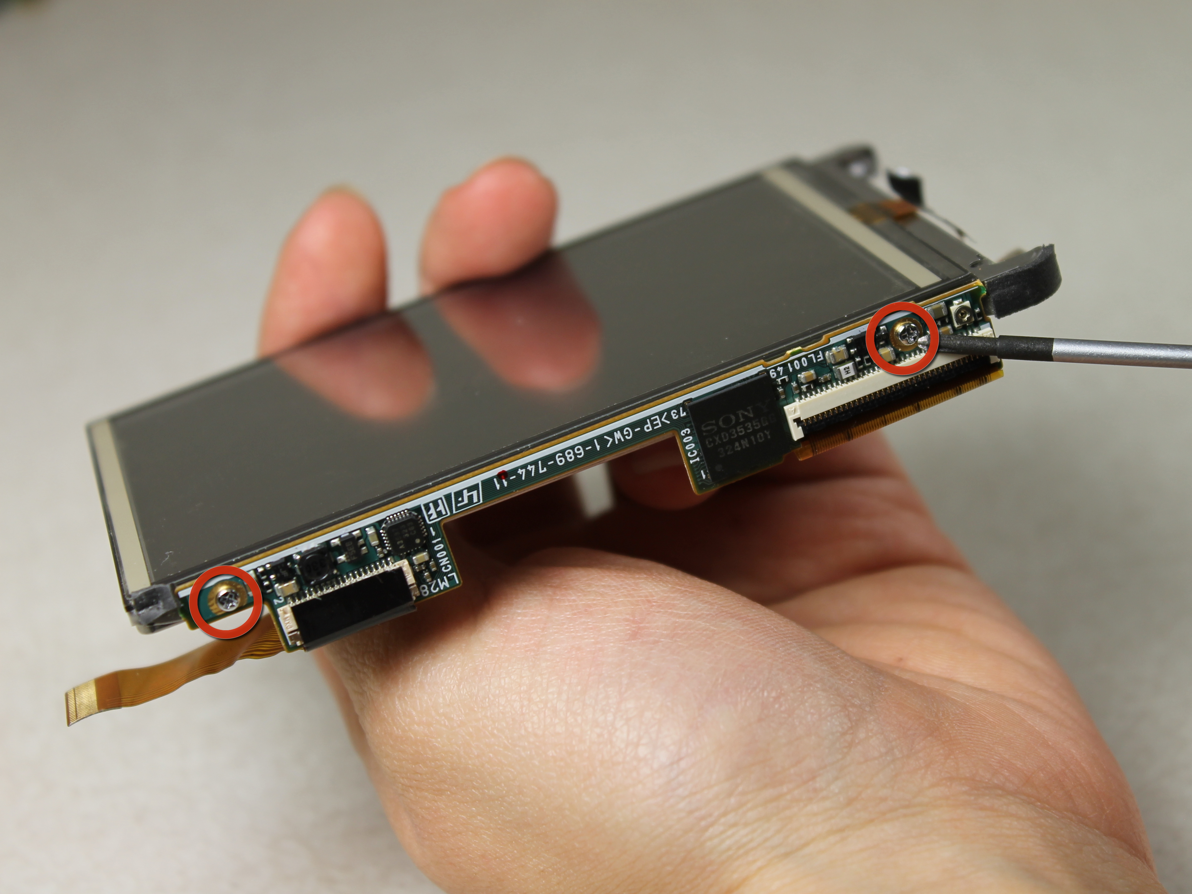

  12. Tapwave T2907US Zodiac 2 Touchscreen/Display Replacement, Touchscreen/Display: step 12, image 1 of 1
    • Unscrew the 2 Philips #00 screws from the bottom edge of the screen component.
