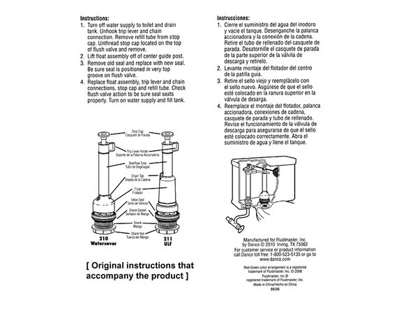

This is a shortcut, time/labor-saving, method of installing a replacement "flush valve seal" to stop water inside the toilet tank from seeping/leaking down the drain (and the continuous, annoying sound that accompanies this water loss).
first image
Add Note Edit Step 1 — Flush Valve Seal  ¶
  • This is the New Valve Seal used in this guide, available at hardware stores and home centers.
  • Using this New Seal installation shortcut method, it will NOT be necessary to do the following (of the original instructions that accompany the New Seal product): "Turn off water supply to toilet and drain tank" and "Unhook trip lever..." [any "chain" will need to be momentarily unhooked.] and "Unthread stop cap..." and "Lift float assembly off....."

  • This is the reverse side of the Flush Valve Seal package.
Flush Valve Seals will need to be replaced, at least, once every few years, depending on water condition. Other kinds of toilet water tanks may have similar assemblies. Why call a plumber for something so easy to do yourself?!
