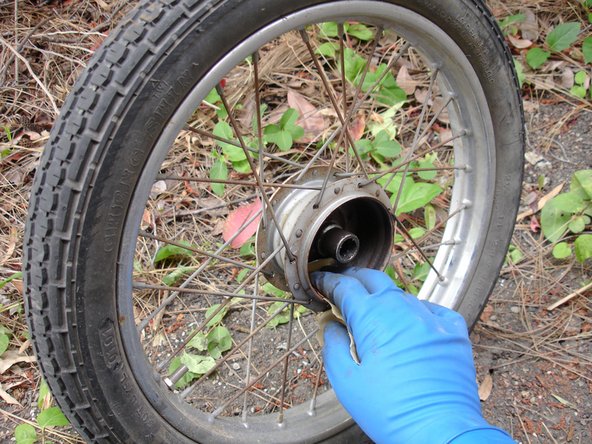

  • Once the solvent has had a chance to work its magic (10 minutes or so), use a rough-grit sandpaper (100 grit or so) to clean the inner diameter of the drum. Rinse and repeat until you are satisfied with the cleanliness of the drum.
Image #1 Image #2 Image #3

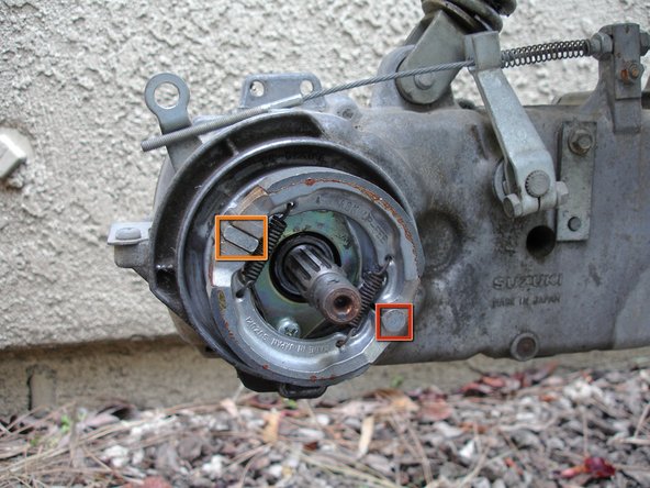

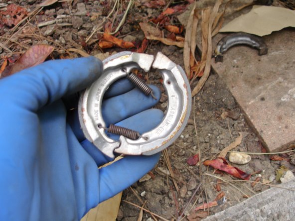

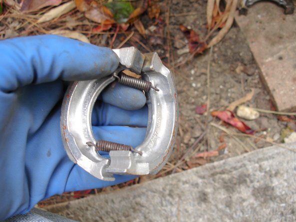

  • Attach the two brake shoes and springs together. First put both springs through one of the shoes, then loosely attach the other side of the springs to the other shoe.

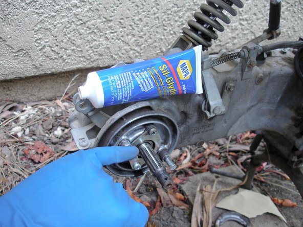

  • Apply silicone grease to the round and flat bolts on the brake drum assembly.
Image #1
Add Note Edit Step 11  ¶
  • Be careful with this part, as the brake shoes are under load. It took me a couple of tries (and different methods) to accomplish this properly.
  • Carefully spread apart the round side of the brake shoes and place them through the round bolt on the brake drum assembly.
  • Then, spread apart the flat side of the brake shoes and place them through the flat bolt on the brake drum assembly.
  • The shoes should now be sitting as shown.
Image #1

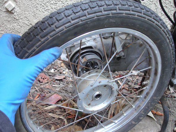

Add Note Edit Step 12  ¶
  • Place the wheel back on the axle. Make sure that the thread of the axle matches up to the thread of the wheel.

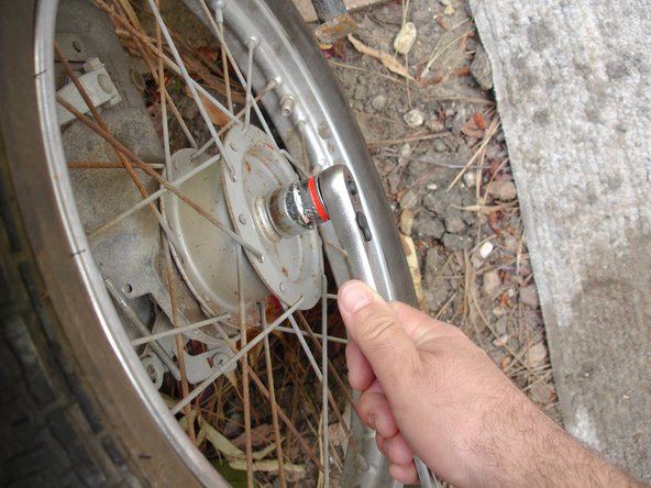

  • Replace and tighten the 22 mm lug nut with a ratcheting socket wrench.

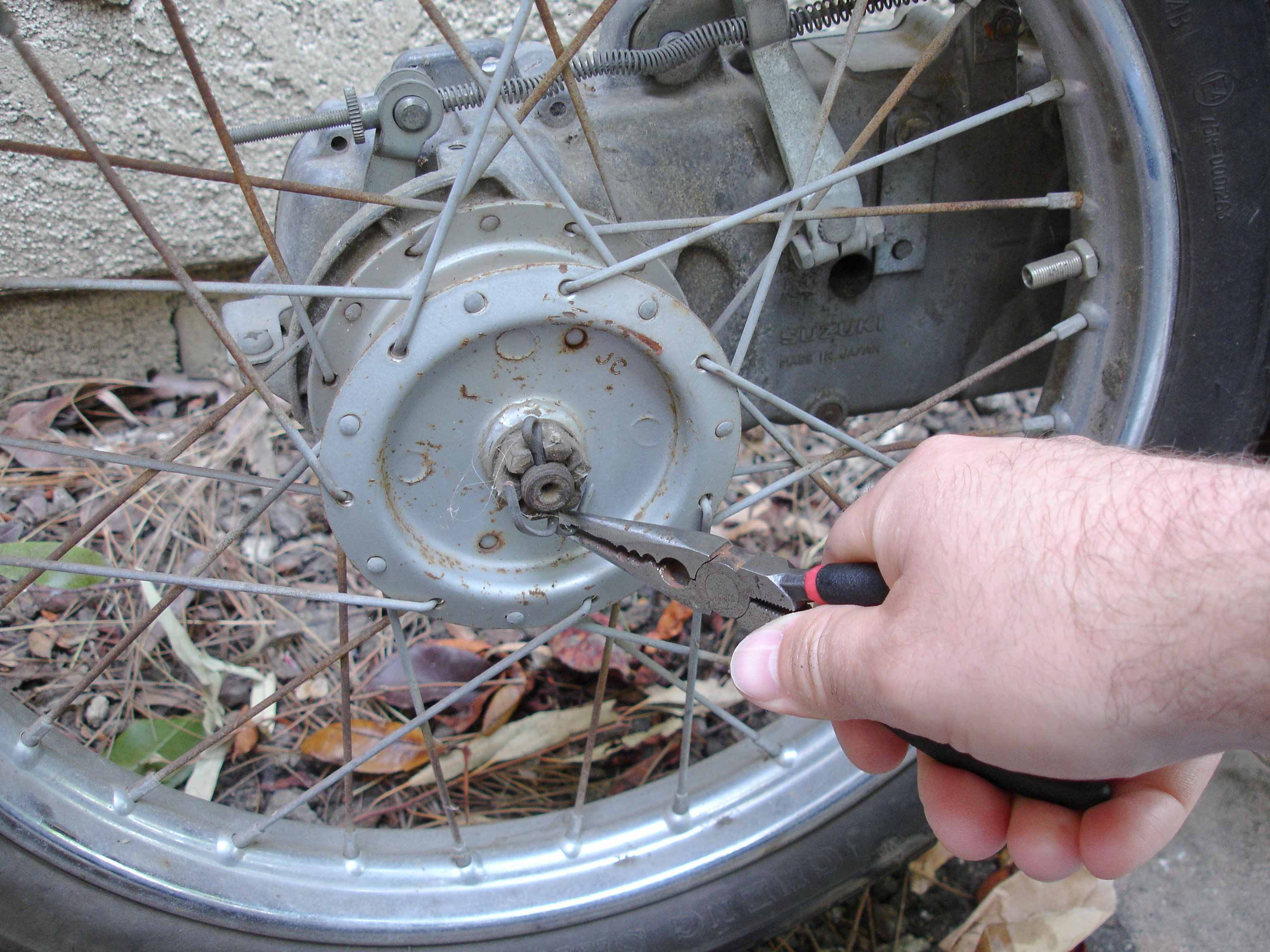

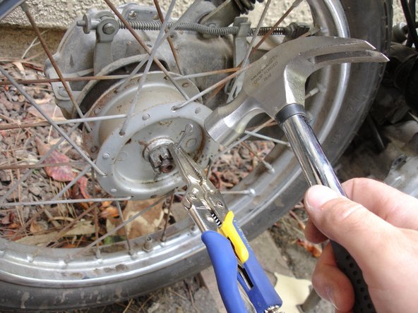

  • Use a hammer and pair of vise grips to slide the wheel retaining pin back into place.
  • Follow the directions in step 2 in reverse order to reattach the brake cable.
  • Adjust the brake cable adjustment nut as necessary. The rear brake lever should be about 0.8" to 1.0" away from the handlebar when fully engaged.
