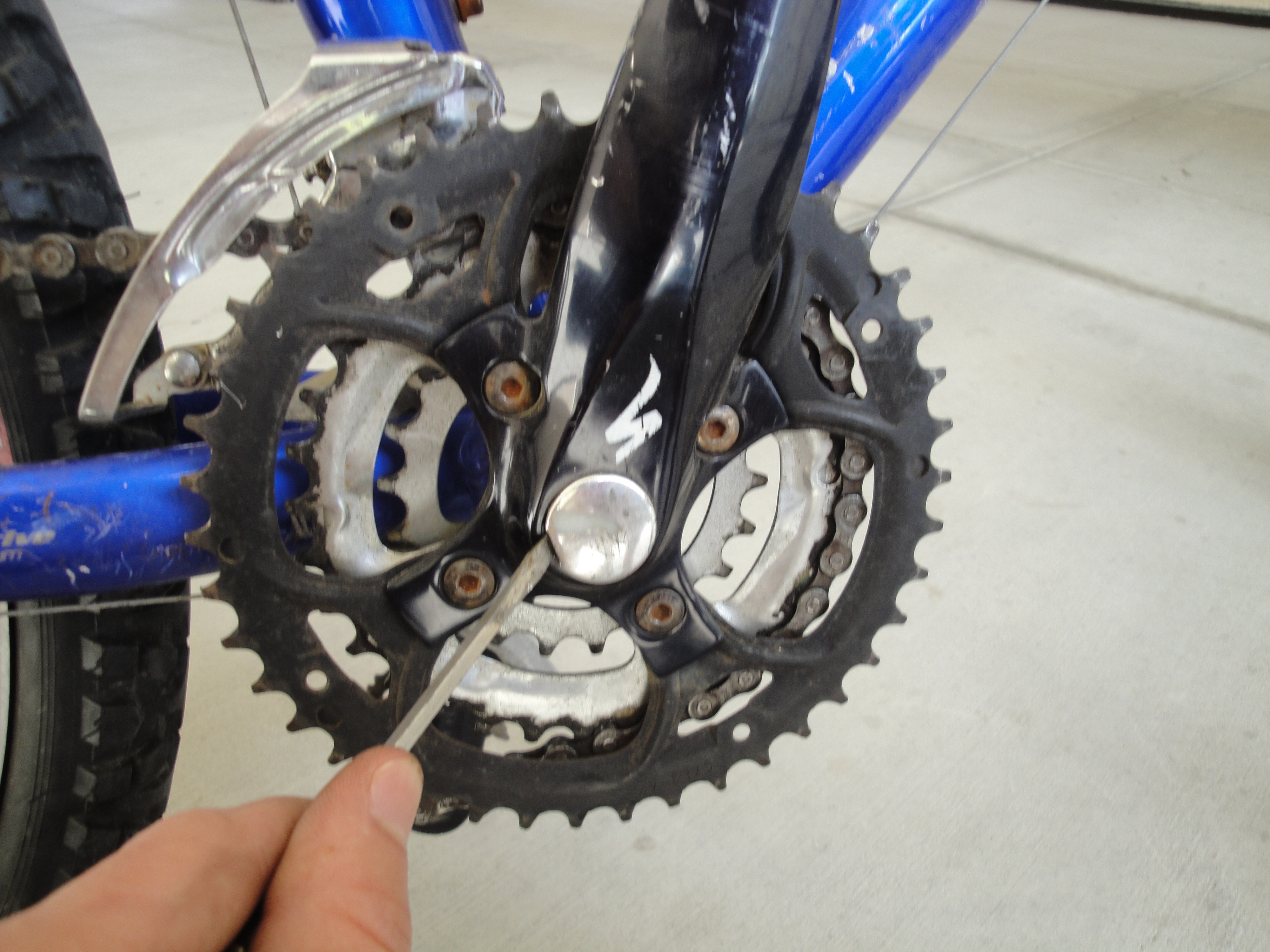

  • Take cap off the crank arm with flat head screw driver. It should just pop off.

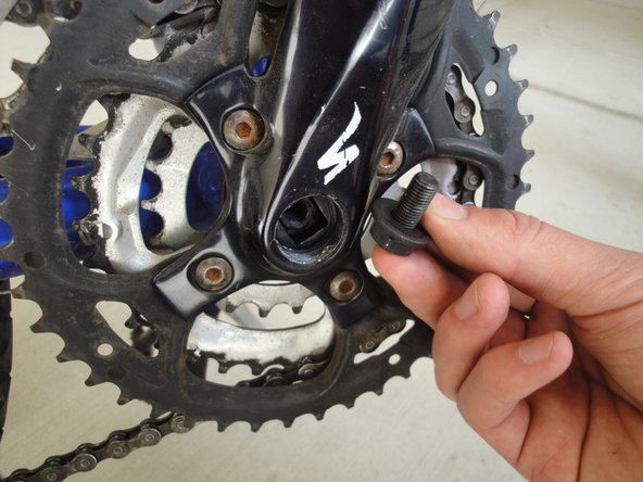

Add Note Edit Step 2  ¶
  • Use a socket wrench to take out the main bolt.

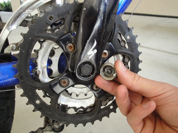

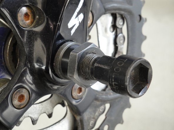

Add Note Edit Step 3  ¶
  • Attach the crank puller to the threads on the crank arm, hand tighten it in until it bottoms out.
  • Be careful not to strip the aluminum threading of the crank arm with the steel threading of the crank puller. Don't force anything.

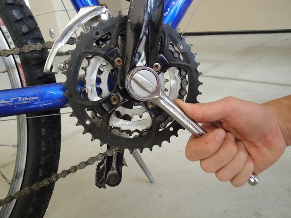

Add Note Edit Step 4  ¶
  • Use wrench to tighten the free end of the crank arm, pulling the crank arm off the bike.

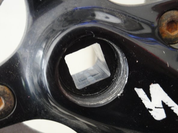

Add Note Edit Step 6  ¶
  • Slide the new crank arm on the the tapered square of the bottom bracket axle.
