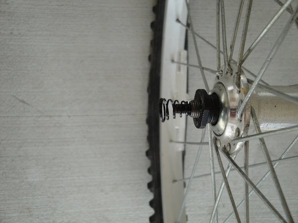

Add Note Edit Step 17  ¶
  • Once in proper position, use the cone wrench and open wrench to tighten the lock nut.
  • Tighten the lock nut VERY tightly. Otherwise the wheel can come out of alignment while you are riding.

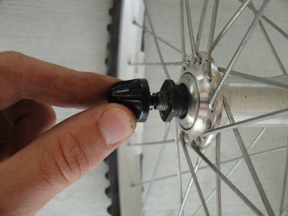

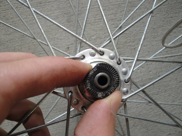

Image #1 Image #2 Image #3
Add Note Edit Step 19  ¶
  • Reinsert the quick release axle, and put the wheel back on the bike.
  • The springs should have the smaller tapered end closest to the hub
