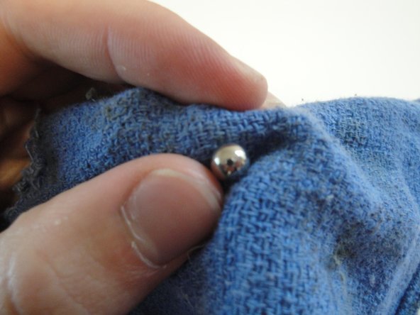

The ball bearings reduce the friction caused by the rotating wheel by concentrating it on rolling bearings, in this case there are ten on each side of the axle. Well maintained ball bearings will help the wheel spin more freely and allow for an easier and smoother ride.
Notes:

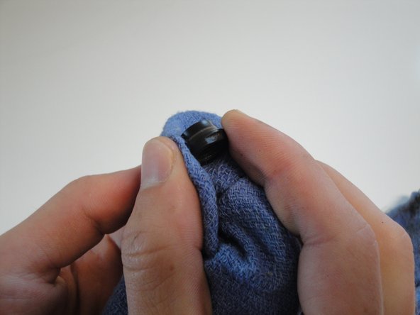

  • When cleaning the bearings and cones, solvents like kerosene can be very effective, however, just a wipe down with a rag is sufficient.
  • When the wheel is assembles correctly there should be very little resistance between the axle and the wheel and each should spin freely of the other.
  • Some of these steps require near-perfect alignment. They may take several tries to get right, so patience is a must.
Image #1 Image #2

Add Note Edit Step 6  ¶
  • Unscrew the cone, and set it aside.
  • Keep track of which side each cone goes on. The order is important because the threading for each cone is specific for each side.
Image #1 Image #2

  • Remove the axle and all ball bearings.
  • Caution: There are 10 ball bearings on each side, be careful not to lose any if you plan on putting the old ones back in!
Image #1 Image #2 Image #3
Add Note Edit Step 8  ¶
  • Inspect cone surfaces and all ball bearings for dents, cracks or blemishes.
  • If any are damaged, replace them.
