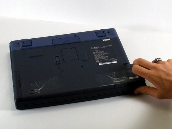

  • Position the laptop upside down as shown.
  • The battery housing is located on the right side of the laptop.
Image #1
Add Note Edit Step 2  ¶
  • Lift the panel up then out to gain access to the battery.
Image #1
Add Note Edit Step 3  ¶
  • Use the indentations to pull the old battery out.
Image #1
Add Note Edit Step 4  ¶
  • Voila! The battery is now removed and it is safe to move on to uninstalling other components, if you so desire.

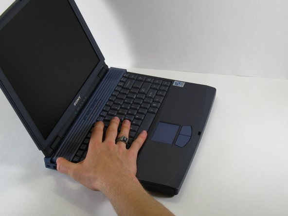

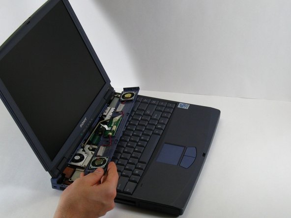

Add Note Edit Step 5 — Keyboard  ¶

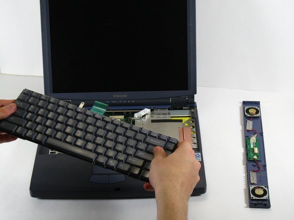

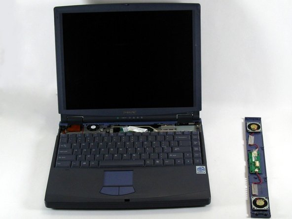

  • There are two screws on the left hand side of the laptop near the IR receiver. remove them using a #00 Philips head screwdriver.
  • Slide the speaker panel towards the left, then carefully flip it over onto the keyboard.
  • Make sure not to pull the speaker panel away from the computer just yet - it is still connected!
Image #1 Image #2 Image #3
Add Note Edit Step 6  ¶
  • Push the beige tab in the direction of the ribbon. it should only move a small amount
  • Remove the ribbon by gently pulling on it, there should be little or no resistance.
  • Now the speaker panel can be set aside.

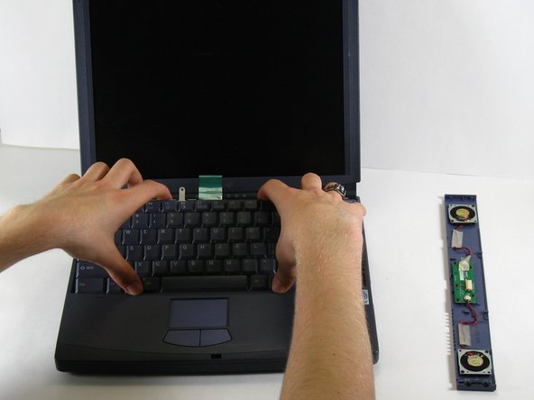

Add Note Edit Step 7  ¶
  • Pull gently to detach the green ribbon at the base of the screen.
  • The keyboard should now come free of the computer easily.

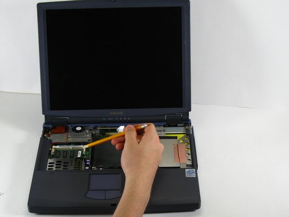

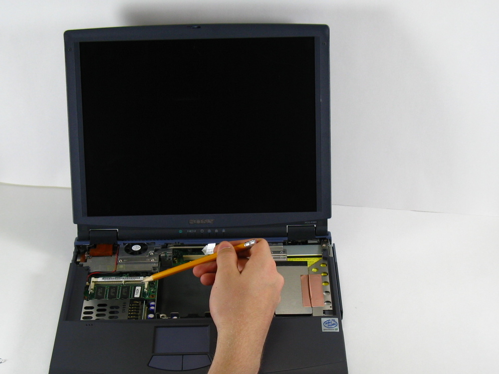

Add Note Edit Step 8 — RAM  ¶
  • Slide your RAM into the housing by aligning it with the plastic, tan colored, guides until it is firmly in place.
  • The computer in the picture only has the standard 64 MB of on-board RAM. This RAM is not removable from the motherboard, but additional RAM can be added.
