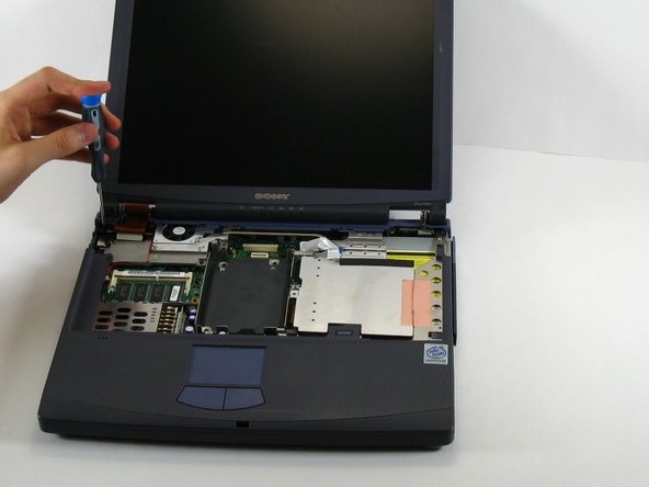

Add Note Edit Step 5 — Keyboard  ¶
  • There are two screws on the left hand side of the laptop near the IR receiver. remove them using a #00 Philips head screwdriver.
  • Slide the speaker panel towards the left, then carefully flip it over onto the keyboard.
  • Make sure not to pull the speaker panel away from the computer just yet - it is still connected!
Image #1 Image #2 Image #3
Add Note Edit Step 6  ¶
  • Push the beige tab in the direction of the ribbon. it should only move a small amount
  • Remove the ribbon by gently pulling on it, there should be little or no resistance.
  • Now the speaker panel can be set aside.
Add Note Edit Step 7  ¶
  • Pull gently to detach the green ribbon at the base of the screen.
  • The keyboard should now come free of the computer easily.
Image #1 Image #2

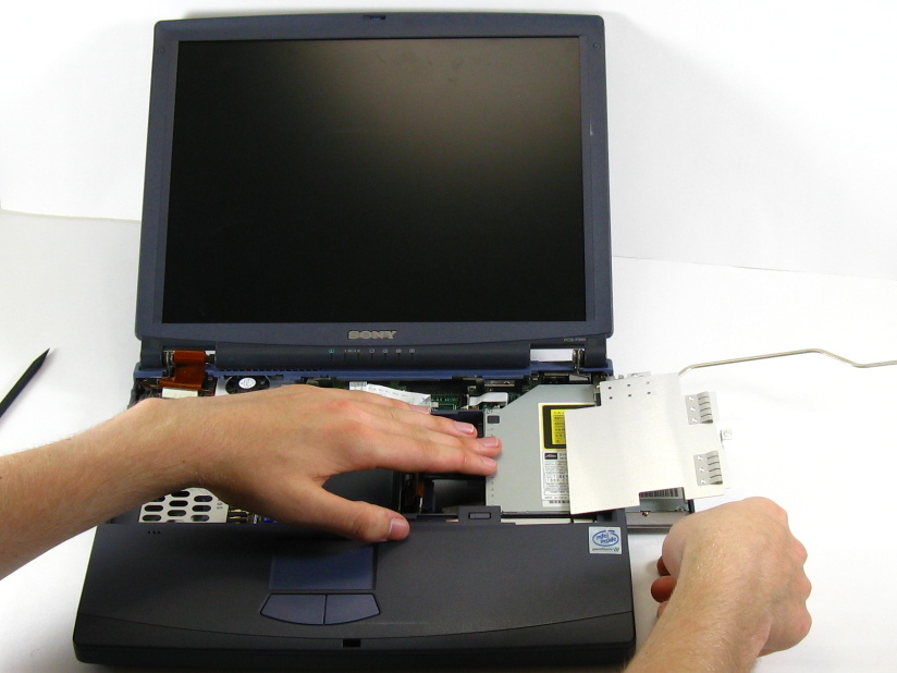

Add Note Edit Step 8 — Optical Drive  ¶
  • Remove the three screws surrounding the fan.
  • Take off the guard that you just unscrewed.
  • Carefully flip over the heat pipe and the metal sheet connected to it.
