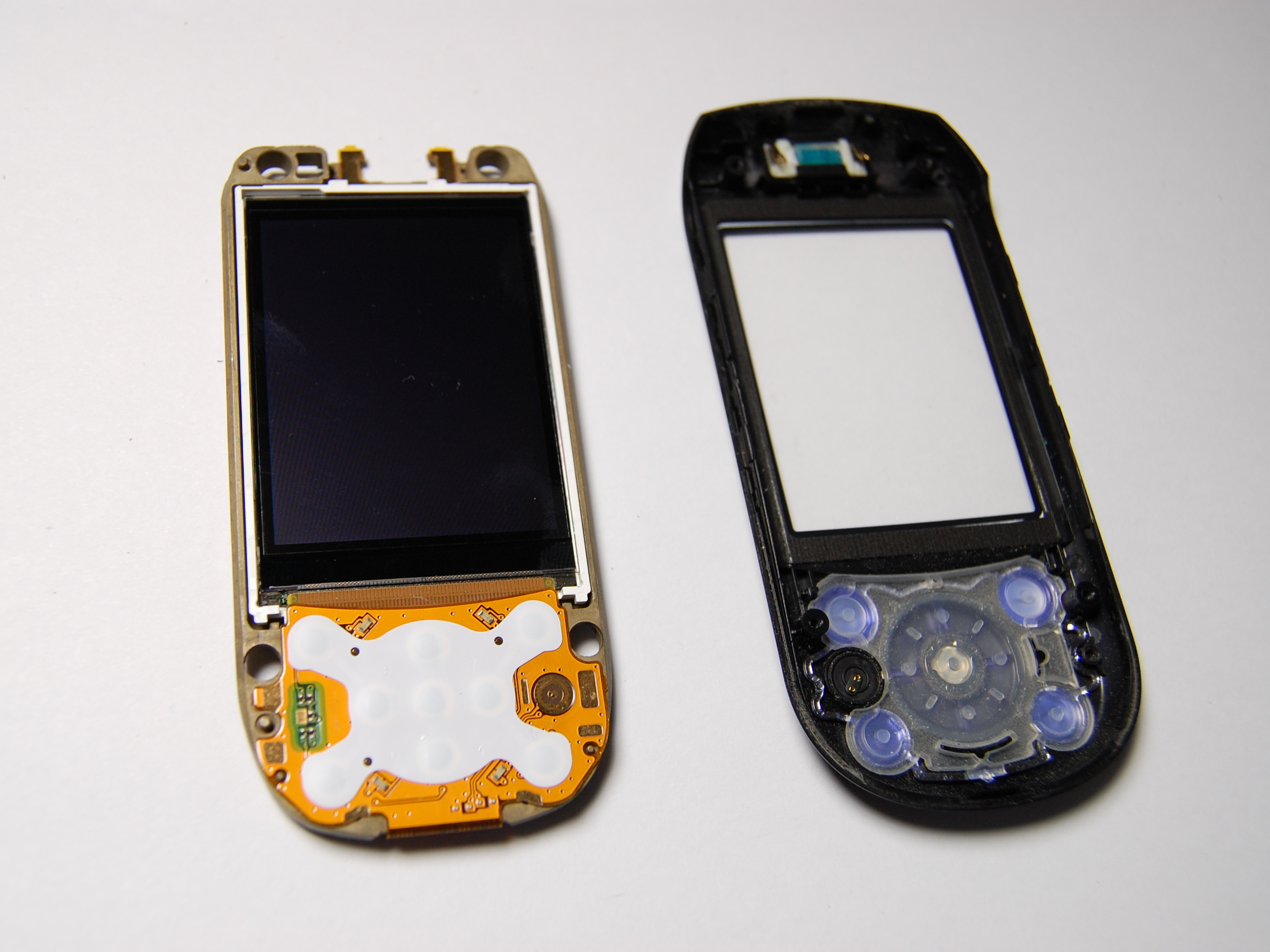

This guide will show the steps for replacing the LCD screen of the s710a if it has been damaged and needs to be replaced or repaired. This can also be used to check the connection between the screen and the motherboard.

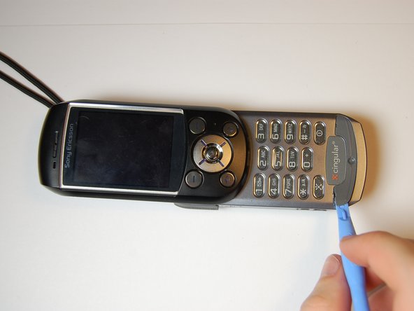

  • Remove microphone cover using a plastic opening tool.
Image #1
Add Note Edit Step 6  ¶

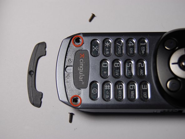

  • Remove the two 6mm screws on the front of the phone beneath the microphone cover.
Image #1
Add Note Edit Step 7  ¶
  • Remove the black plastic piece on the side.
  • This will allow for easier access while prying.

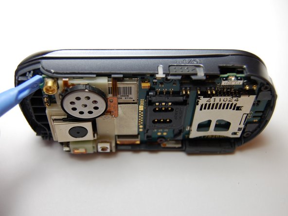

  • Use the plastic prying tool to loosen the motherboard from the phone.
