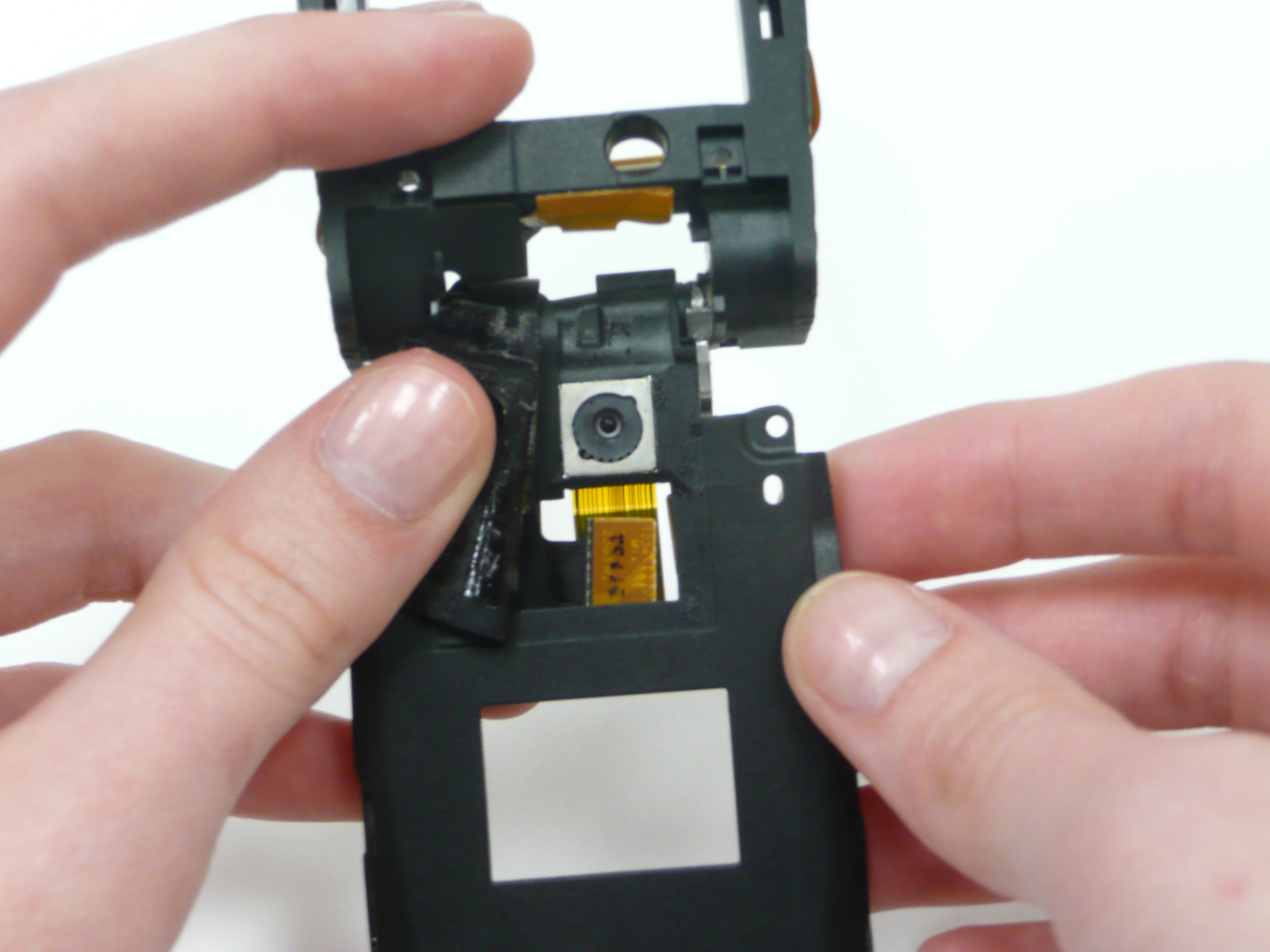

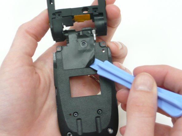

  • Flip the phone over and gently use iPod opening device to remove the right half of the black tape.
  • Be careful because the tape is holding a ribbon wire.

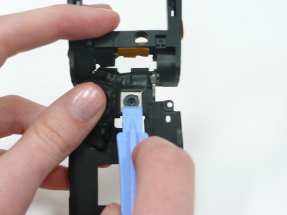

Add Note Edit Step 18  ¶
  • Push metal camera cover through the hole to remove camera.
