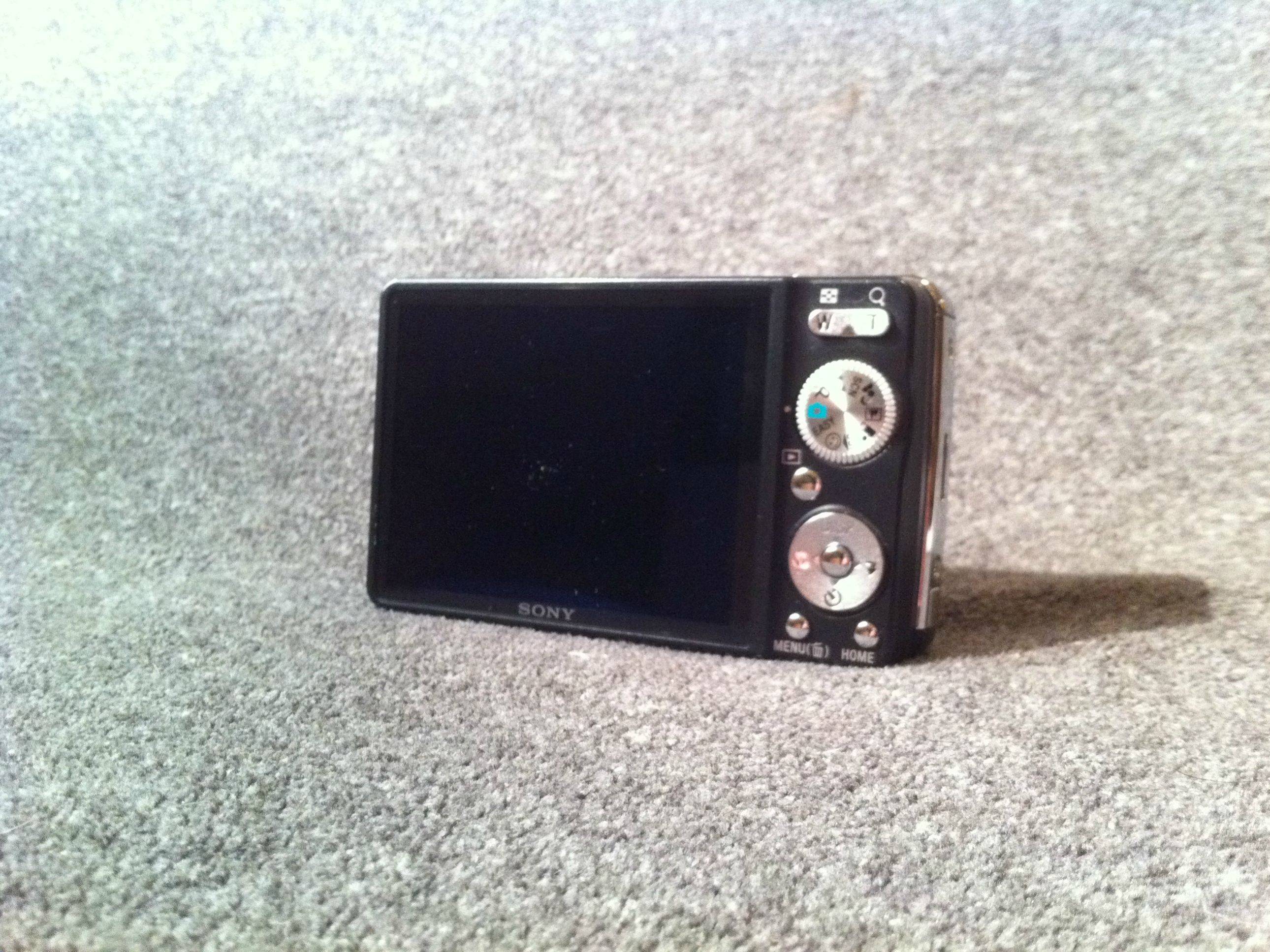

Installation of a replacement LCD screen.
This guide will explain how to take the necessary components of the camera apart in order to replace a damaged LCD display screen.
Image #1 Image #2
Add Note Edit Step 1 — Separating Camera and Display  ¶
  • Align the camera so that the side with "4x Optical Zoom" is facing toward you.
  • Gently twist the bottom corner clockwise until you feel the side panel unlock.
  • Lift off the side panel and set aside.

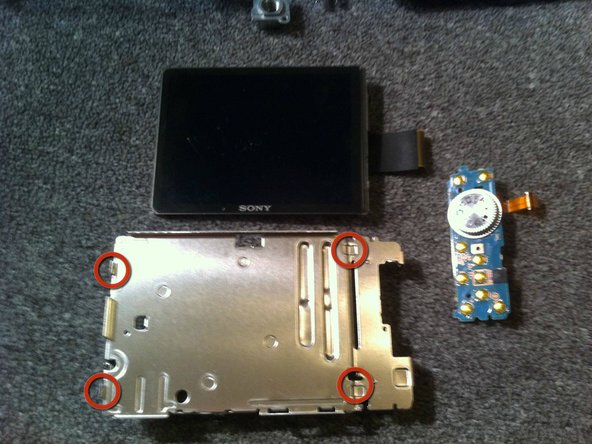

  • Using a flat head screw driver gently pry up the tab securing the ribbon cable from the display screen to the camera sensor and battery housing.
  • Remove the ribbon cable connecting LCD display to camera sensor and battery housing
  • Following the same procedure as above, uninstall the ribbon cable connecting the main camera controls to the camera sensor and battery housing
Image #1
Add Note Edit Step 5  ¶
  • The LCD display screen is now removed from the camera sensor and battery housing.
  • The main camera controls are now removed from the camera sensor and battery housing.
Image #1
Add Note Edit Step 6  ¶
  • Unsnap LCD display screen from its mount by unsnapping it from the display screen using your finger nail.
  • Now the new LCD screen can be installed.
