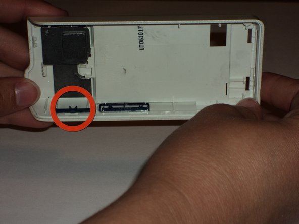

This guide describes how to remove the power button and install a new power button.
The old power button is removed by pushing the power button to the right, pushing up on the power button to lift the left side of the power button over the plastic ridge that was holding it in place, and then sliding the power button to the left. The new power button is installed by reversing these steps.

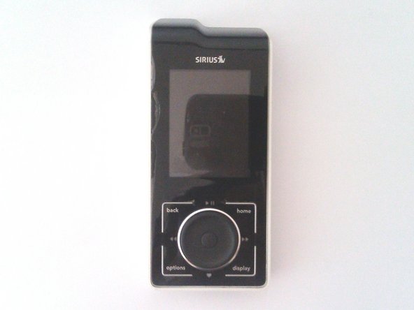

  • Remove the battery (which also functions as the back cover) from the device. This step is not explicitly shown, but a picture without the battery cover shows the device post-battery removal.

  • Use a Philip's head screw driver to remove the screws from the case.
  • Place the screws in a small container to avoid losing them.

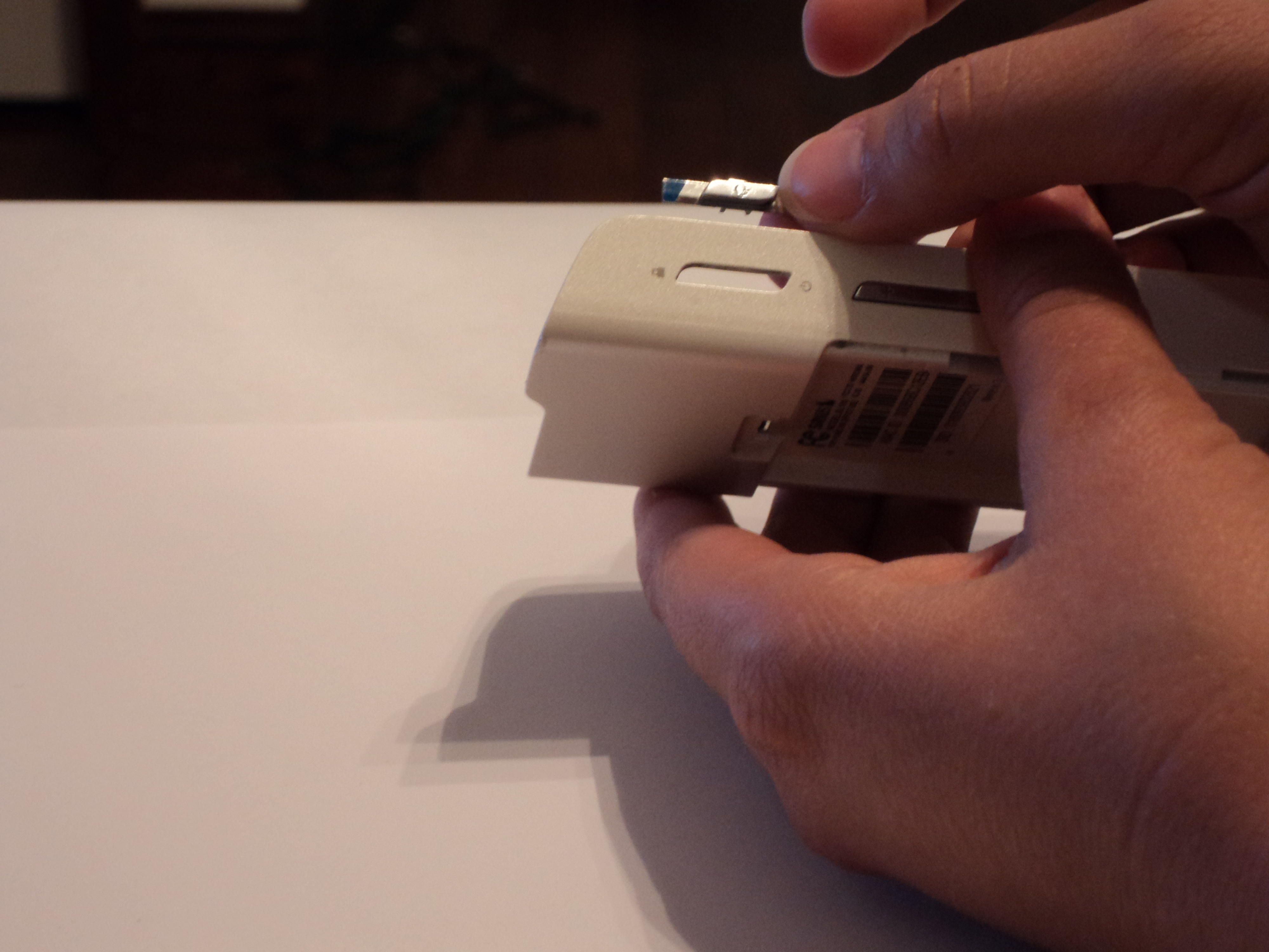

  • Remove the front cover.
    • First, insert a small pry bar where the black front cover and white back cover meet.
    • Begin prying the black plastic up, slowing moving around to the bottom and other side.
    • At an angle, carefully pull up on the front cover separate the two pieces.
  • Excellent! Now you have removed the front cover!

  • Turn the case so that you can see the other side of the power button (so that you are looking at it from "inside" the device). The power button is indicated by an orange circle in the photograph.
