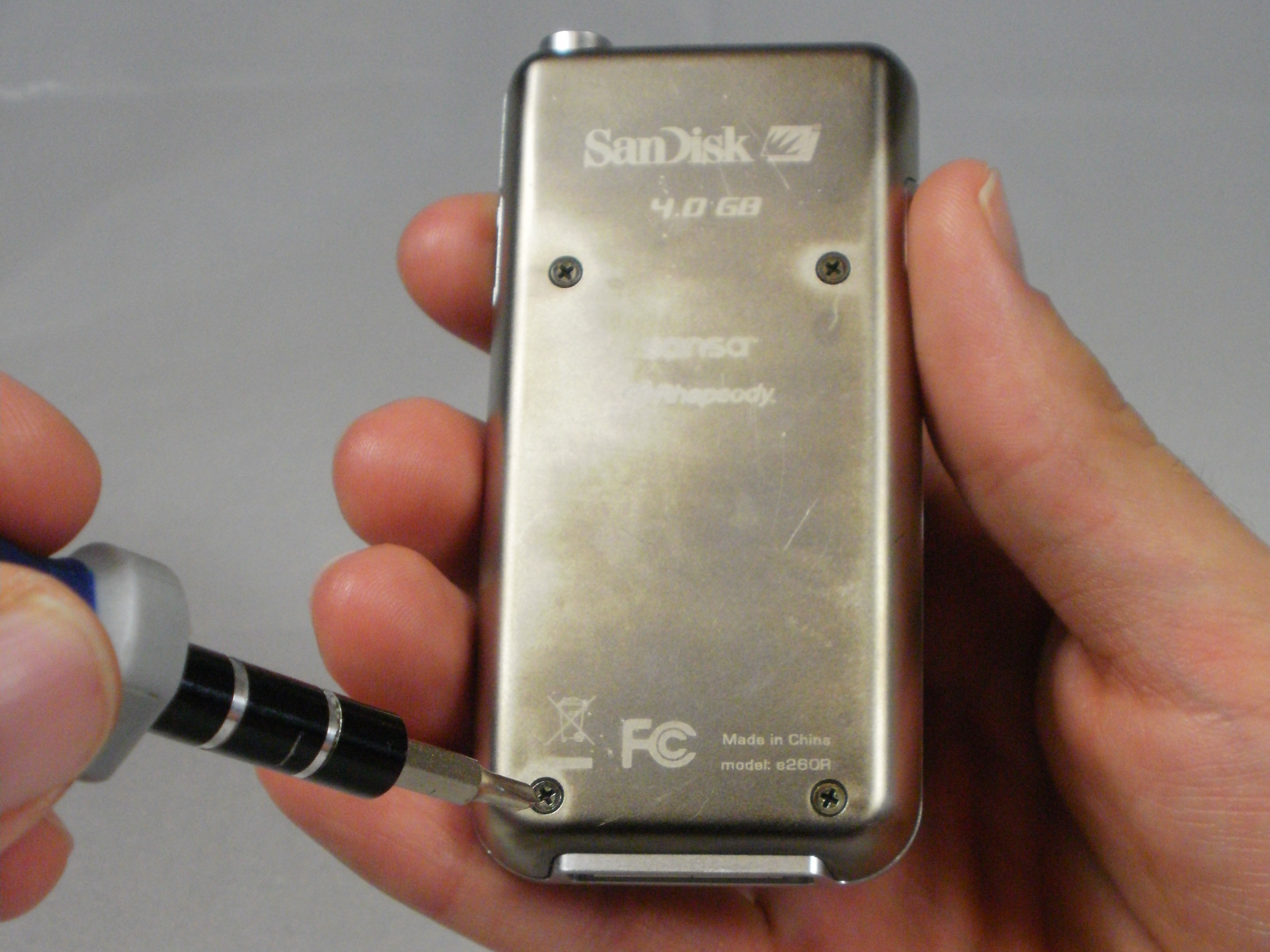

  • Before disassembling the device, make sure it is powered off.
  • Remove the four 1.5mm screws on the back of the device.

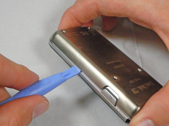

Add Note Edit Step 2  ¶
  • Using a plastic opening tool, lift the metal backing from the front of the device.

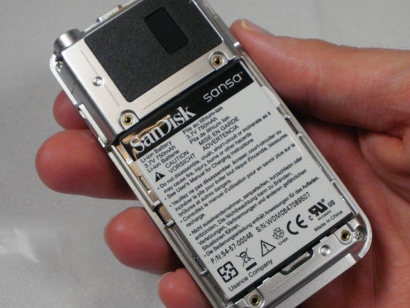

Add Note Edit Step 3  ¶
  • Pull the rear panel off of the Sansa e260R.
