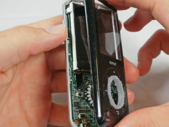

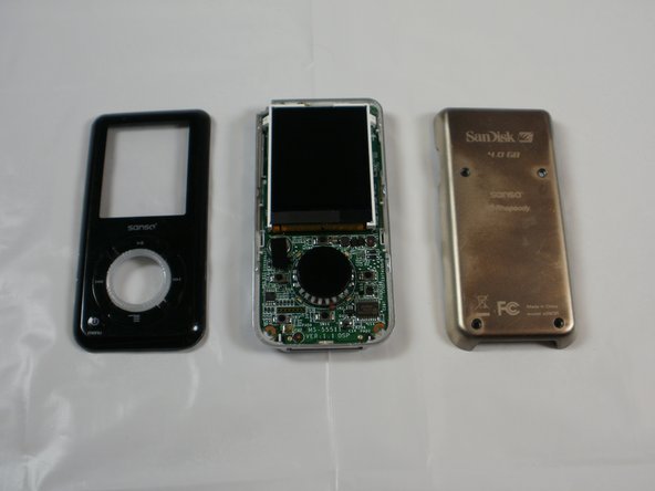

Add Note Edit Step 7  ¶
  • Pull the front cover away from the rest of the device.
Image #1 Image #2

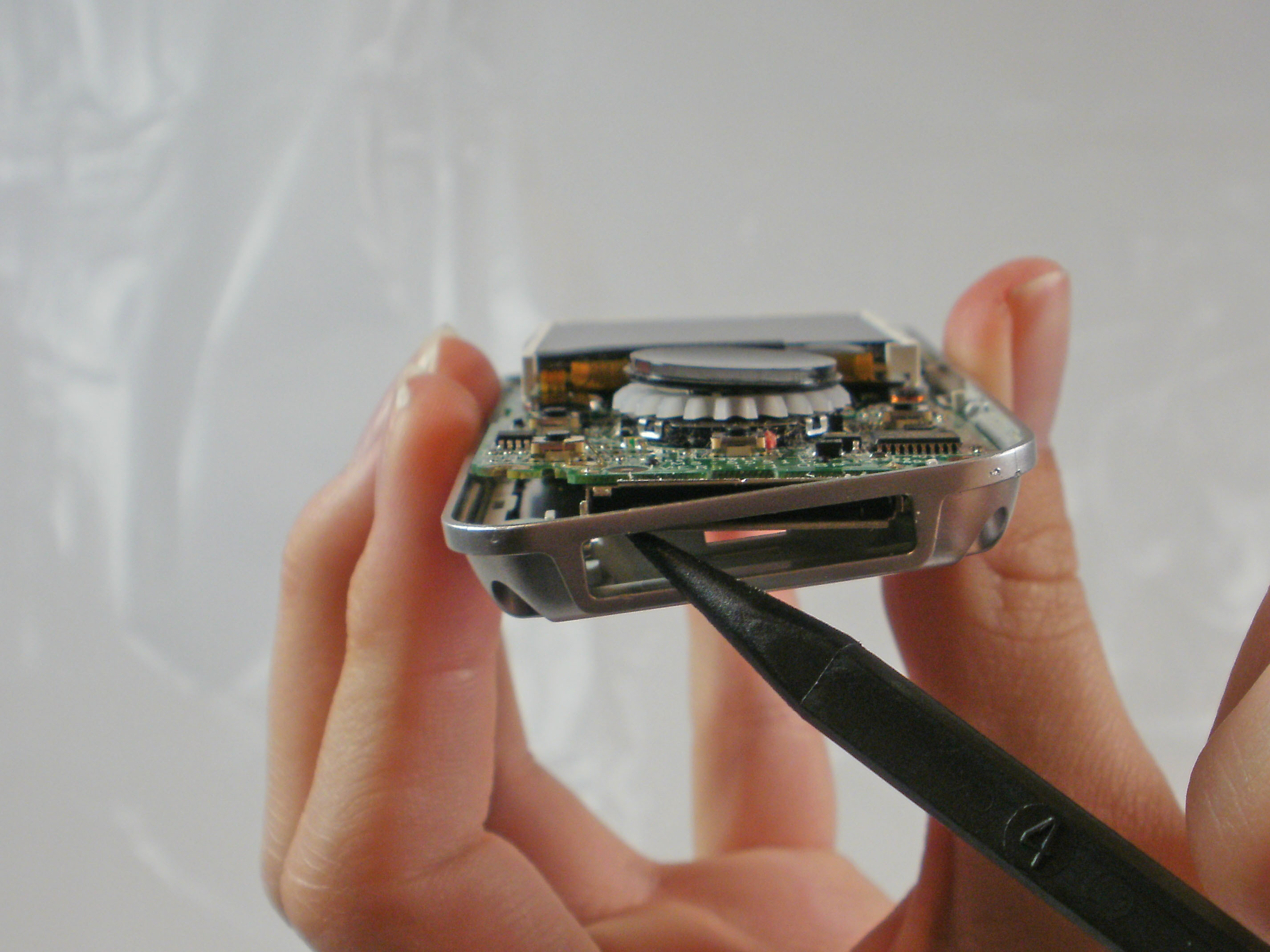

Add Note Edit Step 8 — Memory Board  ¶
  • Near the charging port, pull the case away from the motherboard to create clearance to remove the motherboard.
  • Use the spudger to push the motherboard in and pop the metal edge of the charging port up and inside the plastic case.
