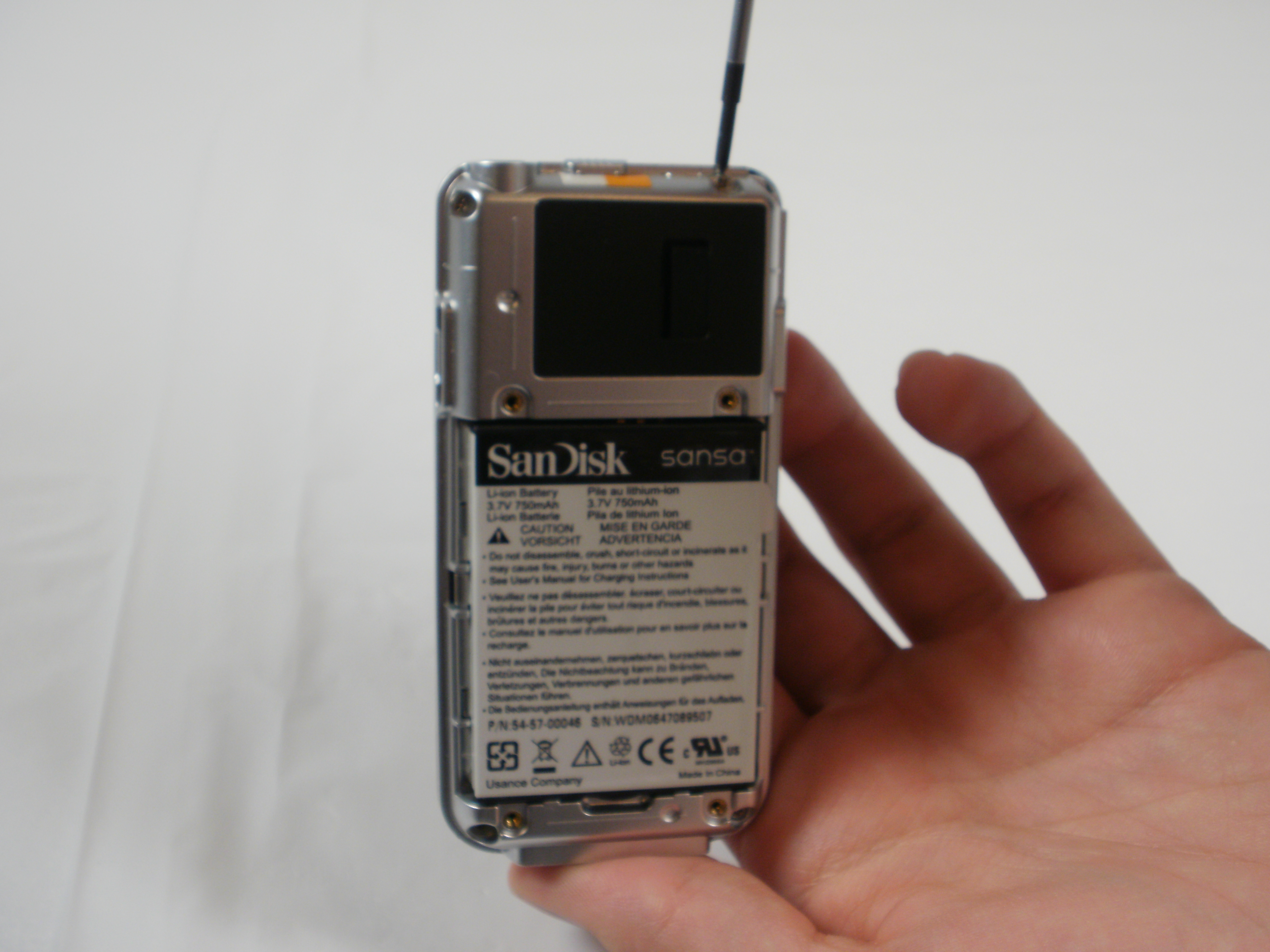

Add Note Edit Step 1 — Rear Case  ¶
  • Before disassembling the device, make sure it is powered off.
  • Remove the four 1.5mm screws on the back of the device.
