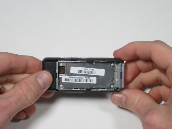

This guide will demonstrate how to replace the headphone jack on the SanDisk Sansa C250 Mobile Media Player.
Image #1
Add Note Edit Step 1 — Battery Cover  ¶
  • Slide the back cover forward toward the top of the device with your thumb.
Image #1
Add Note Edit Step 2  ¶
  • The back cover is now separated from the device.
Image #1
  • Apply a fingernail or a spudger to the base of the battery.
Image #1
Add Note Edit Step 4  ¶
  • Lift up gently. The battery should come up and out.
Image #1
Add Note Edit Step 5  ¶
  • The battery is now removed from the device.
Image #1
Add Note Edit Step 6 — Rear Case Cover  ¶
  • Remove the two black .265" screws at the base of the device.
Image #1
Add Note Edit Step 7  ¶
  • Using a spudger, pry up the two arms of the case cover near the middle of the device to free them from the sides.
Image #1
Add Note Edit Step 8  ¶
  • Slide the rear case cover toward the top of the device with your thumb to release it.
