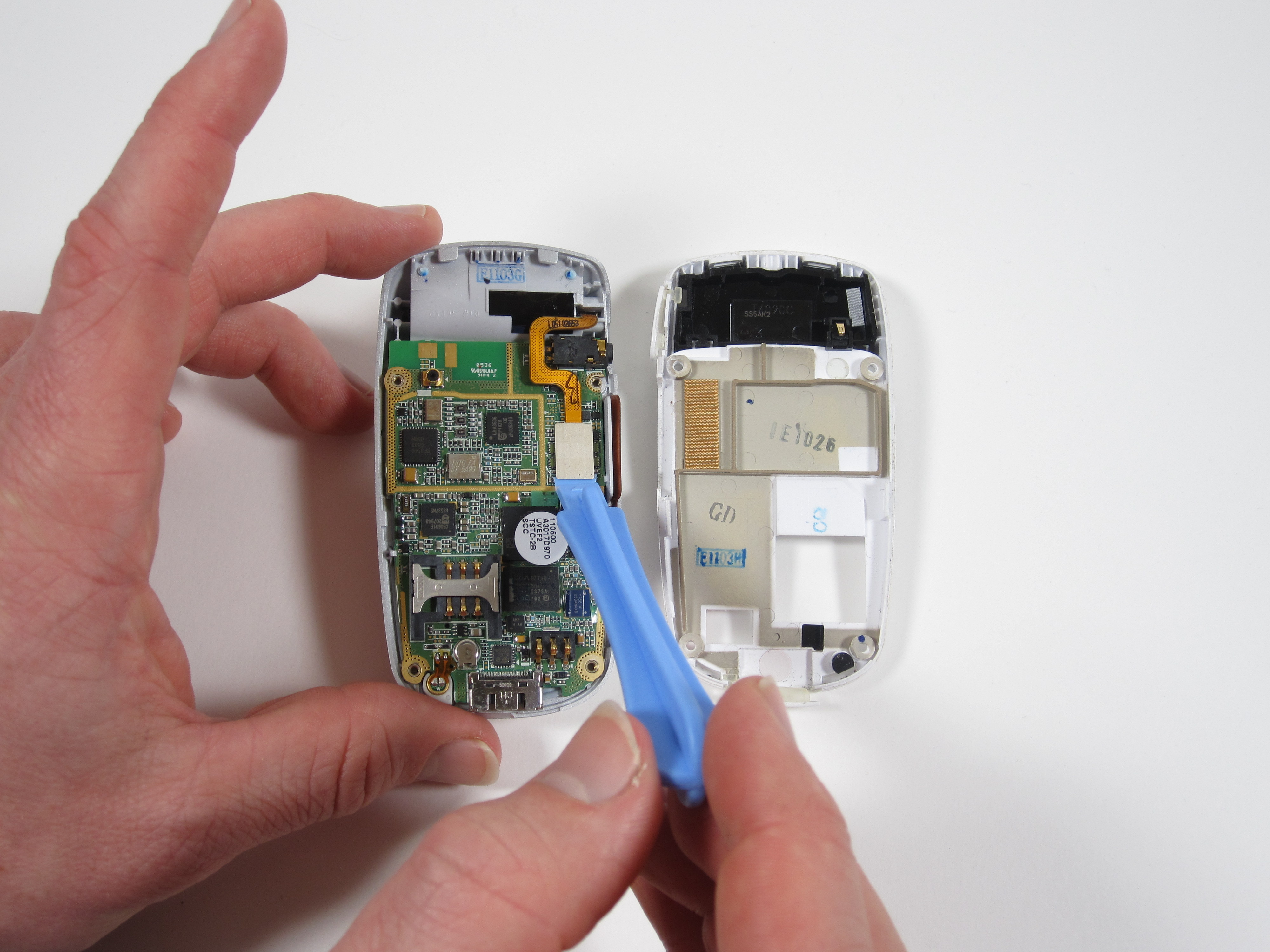

Add Note Edit Step 4  ¶
  • Begin by inserting the pry tool near the charger jack.
  • There are 4 tabs to release.
    • Start at the bottom and slide the tool up, lifting the silver front of the phone away from the white backing.
  • Loosen the 2 side tabs before moving on to the top two.
  • See the second photo to see location of the tabs.
  • Be careful of the ribbon wires shown in second photo.
Image #1 Image #2
Add Note Edit Step 5  ¶
  • Once the two side tabs are free; gently pry the white backing down to release the top two tabs.
  • Hold the phone with the left hand as shown
  • Wiggle the white backplate from side to side while pulling down with the right hand.

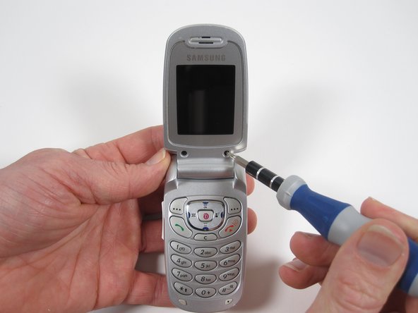

Add Note Edit Step 6 — Face Plate  ¶
  • First remove the 2 silver stickers with a a safety or push pin to reveal 2 screws.
Image #1
Add Note Edit Step 7  ¶
  • Remove the 2 (5.6 mm) philips head screws.

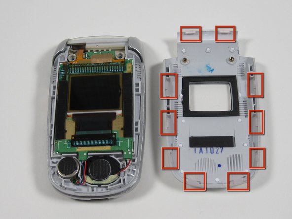

Add Note Edit Step 8  ¶
  • Using a plastic pry tool, begin at the top corner as shown and work down each side. The face plate has 10 tabs that hook into the phone's body.
  • Free the 3 tabs on either side prior to the 2 on the bottom.
  • The bottom 2 are the most challenging to remove.
    • Note: when reassembling start with the bottom two tabs.
